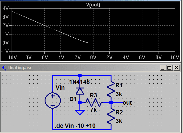

I can only suggest that you enter the OP circuit into a Spice simulator such as LTspice and try to solve it without the ground symbol. Then once you insert a ground symbol somewhere, the numerical solution becomes possible.
The whole thing looks a bit cryptic to me. The voltage across R7 which is Vo(t) is irrelevant to whether there is a ground symbol attached to the node or not assuming that we hook a voltage/current source on Vi(t) that does not have the same ground symbol attached to one of its nodes. I guess we are to assume a completely isolated source. Seems this is an exercise in analyzing schematic symbols correct? If I were designing a test for just such a purpose this would be a good example.
Vi is not completely floating. Both terminals are connected to Earth via resistors of equal value. If Vi is positive then Vo=0.
For positive Vin it is simple, Vout will be zero.
For negative Vin, with a perfect diode, the (7k in parallel with upper 3k), forms a voltage divider with the lower 3k. Then Vout = –41.2% of Vin.
Here is the simulation.
Thanks for all the replies, I was just confused about the symbols. I've just always assumed that symbol meant an ideal voltage source. The solution is rather trivial if we assume an ideal voltage source and ideal diodes, namely
Vo(t) = 0 for Vi(t) > 0
Vo(t) = -0.41Vi(t) otherwise
To earlier statements about the circuti being wrong since Vi(t) isn't with respect to ground, I think the circuit is correct. Vi(t) is just the difference between the (-) and (+) terminal.. Vo(t) is the drop across the resistor. We can just think of them as ideal voltage sources, and then they don't have to be with respect to ground.
Yes - that`s true. What does this mean? The ground symbol has no effect at all. For positive Vi there is no current through R3 (open circuit).
That`s what I wanted to say about this matter in my previous posts.

It actually means that by selecting an appropriate reference ground you can produce a counter intuitive, half wave inverter, all without needing an active device. The circuit was clearly designed to be sufficient to confuse most students.
The floating voltage source, Vin, is not a problem at all. Vin could be replaced by a transformer secondary. By selecting the appropriate reference terminal, a transformer secondary by itself, can make a full wave inverter.
The ground reference on a circuit schematic is not always there to provide a common ground node for circuits, signals or power currents. It may be there simply to protect the circuit from breakdown of the insulation. For me, that is a good enough reason for having one ground symbol somewhere on every circuit schematic. It is an essential engineering component.
