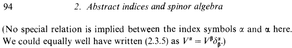

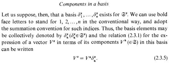

Here are sections from Penrose & Rindler's Spinors and Spacetime
From p.93 in vol I, in Ch 2 of the Abstract Index Notation
then at the top of the next page
Here's something from p.81 showing an explicit summation symbol for a different combination of indices
Thanks for the reference! I admit there are a lot of complexities in this subject that I am not expert on.
