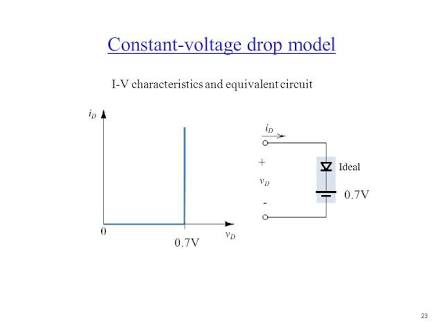

What I am confused on is that if the diode is turned on, then the branch with the diode is a short circuit, so why is there current going in the R2 branch?
The book solves all the problems like this one the same way, but I don't really get it. Are we assuming the diode is actually on the brink of turning on/off, so it allows current through it, but it's actually not a short circuit yet?
What does VD.on represent? Is the diode treated as ideal or non-ideal in these problems? :wink:
No. You are asked to use the constant voltage model for the diode.
Likes timnswede
Oh wow, not sure why I didn't realize it until you guys said it, but now it makes sense, thanks!
