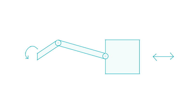

I'm sure there's an obvious answer to this, but this problem has been confusing me for some time.
Imagine there were a massive object attached to the end of a crankshaft. A force is applied to accelerate the crankshaft, causing the mass to oscillate. Assuming there is no friction, what would happen to the system when the force is no longer applied? It shouldn't be possible for it to slow down if there's no energy loss, but wouldn't it require a force to continue to accelerate the mass back and forth?
picture is needed
zwierz said:
picture is needed
I'm not exactly sure what you're looking for, but this is the basic idea.
the system will oscillate This is a Hamiltonian system with one degree of freedom
And it will continue to oscillate at the same rate even when the torque is no longer applied?
What does the "rate" mean? This will be nonlinear oscillation. Is gravity applied?
I mean the frequency of the oscillation of the mass. I don't understand what you're asking.

I haven't quite locked on to what the problem is but let's try a few things :
The configuration is like that of a normal I/c engine . Crankshaft , connecting rod and notionally a piston . The piston has a large mass but the other components are massless . Conventional arrangements of bearings etc. but with zero friction .
If the crankshaft is initially rotated at constant rpm by an external power source then the piston will move back and forth in a straight line . Motion will be something like SHM but with some higher order motion components added .
When the external power source is disconnected the piston will continue to move until it reaches an extremity of it's travel where it will stop .
To make the motion continue beyond that stop point there needs to be a heavy flywheel fitted to the crankshaft .

I don't see any contradiction between what AT has said and what I have said .
When the external drive is disconnected the piston will just continue in motion until it can go no further . There is then no torque on the crankshaft to make it rotate and no force on the piston to start it moving again .
To make the motion keep going there needs to be enough residual rotational KE in the crankshaft to carry it past dead centre and then generate enough torque to produce a force in the connecting rod sufficient to start the piston moving again .
Zero mass crankshaft components can't store any KE at all .
In a real situation the crankshaft components themselves could be made sufficiently massive to store enough KE but more commonly the crankshaft components are kept relatively light and a massive flywheel is fitted instead .
All right. So here's my understanding of how it would work.
If the mass of the flywheel were extremely large and the oscillating mass extremely small, the angular velocity of the flywheel would be almost constant. As the former decreases and the latter increases, the angular velocity would fluctuate to a greater extent.
If the system were connected to the earth, it would cause the Earth to oscillate (extremely slightly).
If the mass of the rods and flywheel were nonexistent, when the velocity of the oscillating mass reaches zero it would remain still because there is no stored kinetic energy.
If there were no friction in the system and the connecting rods had any mass at all, it would oscillate perpetually.
Is this the right idea?

Not quite . There is a minimum value of energy storage capacity needed in the flywheel / crank / con rod assembly to ensure continuous motion .
Please note that trying to explain exactly how a theoretical system that can't actually exist works is difficult and often misleading . You would be better off from this point on in this discussion if you drew up a realistic system which we could then analyse more definitively . When you see how the energy in a real system transfers between components you should be able to understand all of this problem much more easily .
Anyway if you want to continue we need to develop a proper mathematical model of this type of system .
All right. I think the problems I'm used to dealing with are simple enough that I never have to deal with the inconsistencies of these theoretical cases (I'm only in high school taking regents physics).
Should I provide specific values for the mass of the rods (and possibly the friction) or should I just assume they're low but not nonexistent?
If I assume that they are low, would my equation τ=mω^2l^2 (which didn't take into account the mass of the rods) still be a good approximation.
  • #31
No need for numbers . Algebra variables are what we will use . We can keep the actual maths quite simple .

Seems simple enough. Finite mass on the piston, rigidly mounted crank-case/engine block. Frictionless bearings and frictionless piston rings. Watch what happens as the mass of the crankshaft and connecting rod decrease toward zero. There is always an increase in crankshaft angular velocity near top dead center and bottom dead center. As the mass of the crankshaft and connecting rod decrease toward zero, the peak angular velocity diverges toward infinity.
There is no convergence toward a physically reasonable limiting behavior. Something will break first.
  • #33
All right. My train of thought before making the thread was this:
I know that when the mass is momentarily still, the acceleration is at its maximum. I can find that acceleration, and then find what the angular acceleration would be at that point. This would allow me to find the maximum torque. It did give me an equation (τ=ω^2l^2m) which passes dimensional analysis and seems reasonable, but I never considered the mass of the rod. Does this calculation make any sense to do, or should I go back to the drawing board completely?
