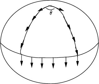

Is it correct to explain parallel transport the following way?
As long as the path follows a geodesic, the angle of the transported vector and the path's tangent is constant. When the path deviates from a geodesic in one direction, the transported vector changes it's angle to the path's tangent in the opposite direction by the same amount.

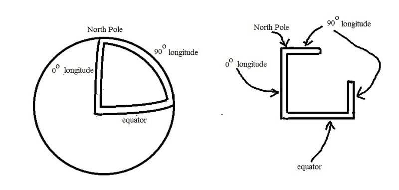

Well, the best example is the one from A.T. about parallel transport on a globe. I'll use that example to illustrate the problem.
Suppose that we want to parallel-transport a vector around the following path:
  1. Start at the North Pole and go straight south along the line of 0o longitude until you get to the equator.
  2. Go straight east along the equator until you get to the line of 90o longitude.
  3. Go straight north until you get to the North Pole.
Note that this is an "equilateral triangle" of sorts, because all 3 legs of your journey are the same length, 1/4 of the circumference of the globe. But unlike a triangle in flat 2D space, the angles are not 60o but 90o. In the figure below, on the left is shown the journey on a globe. I took a narrow strip centered on the path and "opened it up" to flatten it. The flattened version is shown on the right. Note that in order to flatten the path, I had to break one of the legs of the triangle. I chose to break the last leg, the journey north along the line of 90o longitude.
Now, my claim is that parallel transport within the strip on the left is the same (at least approximately) as parallel transport within the flattened strip on the right. So within the strip, you can just use Cartesian coordinates to define parallel transport: just keep the components of the vector the same as you march around the strip.
However, one section of the strip is broken--the trip along the line of 90o longitude. If you start off at the North Pole, there are two routes to get to this section: You can either travel south along 0o longitude, then east along the equator, and then north along 90o longitude. Or alternatively, you can just go south along 90o longitude. The orientation of that section of the path if you go along one route is rotated 90o with respect to the orientation of that section when you go along the other route.
So that's a way to think about path dependence of parallel transport in curved space. You could take a path and flatten it out, and just use Euclidean notion of parallel transport, but in order to flatten it out, you have to break some sections of the path. At those breaks, the orientation of that section of the path is different, depending on how you get to it. If the space is curved, then there is no way to flatten it without breaks, and the breaks imply path-dependence of orientation.

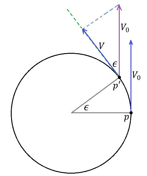

To get some feel for why the length of the vector doesn't change during parallel transport, you can look at a simple example of transporting a vector around a circle.
Suppose you start with a vector of length ##V_0## that is tangent to the circle at point ##p##. Slide the vector to point ##p’## such that it remains parallel to it’s original direction to produce the purple vector of length ##V_0##. Then project this vector onto the tangent at ##p’## to produce the “transported" vector of length ##V##. If ##\epsilon## is the angle subtended by arc ##pp’##, then the length of the transported vector will be ##V = V_0\cos \epsilon##.
If you were to let ##\epsilon = \pi/4##, then you could get around the circle in 8 steps. Each step would reduce the length by a factor of ##\cos \pi/4## so that the length after returning to ##p## would be reduced overall by a factor of ##(\cos \pi/4)^8 = 1/16##.
But, we want to consider very small steps. For small ##\epsilon## the number of steps to get once around the circle is about ##2\pi/\epsilon##. So, the vector will be reduced overall by a factor of ##(\cos \epsilon)^{2\pi / \epsilon}##. The limit of this expression as ##\epsilon## goes to zero is 1. So, the vector retains its length when you take "infinitesimal steps".
