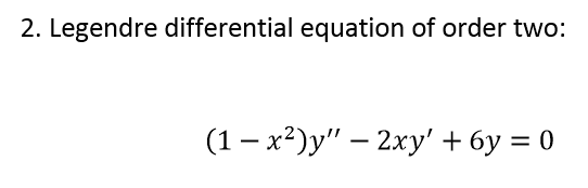

ok considering one of the Legendre differential equations
so for this the normal first kind solution is only valid between -1 and 1 ?(where the singularities occur)
also speaking of locality, so in the case where there is no singularity the series solution becomes the global solution
say for something like
\frac{d y }{d t} = t
series solution gives us ## y = e^t## which also happens to be our global solution
or is this because the radius of convergence of e^t happens to be infinity that's why the local series soltuion become the global solution also which one is it? thanks you have already helped me clear up a lot

Yes. Exactly correct.

The convergence of the series is up to the nearest singularity in the complex plane. So if there are no singularities in the complex plane, the series solution is good everywhere. A factor of ##(1+x^2)## in your first example would probably be a problem in the complex plane because of ##x= \pm i ##.
