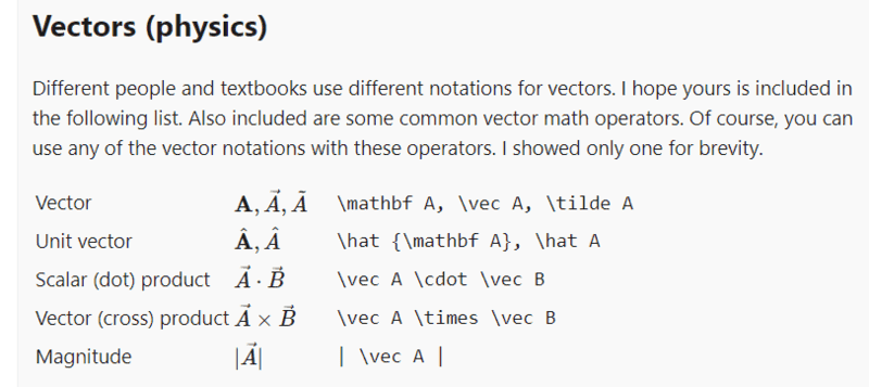

Please have a look at the "LaTeX Guide" link below the Edit window. That will help you to post your math equations in a much more readable form. Thank you.
