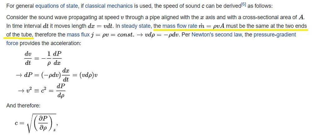

I've having trouble understanding a derivation of the speed of sound waves, which is actually similar to another derivation I found a couple days ago.
Let's suppose the sound is moving through water in a long cylindrical horizontal pipe. The premises of the derivation are
1.) For a given cylindrical slice of water of thickness [itex] \Delta x [/itex], the net horizontal (direction of the wave motion) force acting on the water is proportional to the hoizontal pressure gradient times [itex] \Delta x [/itex], so [tex] \rho \frac {dv}{dt} = \frac {- \partial P}{\partial x} [/tex]
2.) the mass flux through any infinitely thin cylindrical slice is constant, or
[tex] \frac {d ( \rho v) }{dt} =0 [/tex]
And from these premises one can arrive at [tex] v^2 = \frac {dP }{d \rho } [/tex].
What I don't understand is why the second premise is true, since neither the water density nor water speed is constant. Or perhaps I don't understand the second premise: Is it supposed to be for an infinitely thin slice, or for a cylinder of thickness [itex] \Delta x [/itex], or something else?
Thanks.
For the Wikipedia entry "Speed of sound" they refer to "the two ends of the tube", which seems to me to be a very strange body of fluid to be looking at when the wave itself can be contained within a small fraction of that length.
What you describe in words as equation 2) would be more like ##d(\rho v) / d x##. But what you state mathematically is that the mass flux doesn't change in time at any point. That is of course weird. Furthermore, these are all partial derivatives since ##v## and ##\rho## are dependent on both time and location. It is however close-ish to the linearized continuity equation:
\frac{\partial\tilde{\rho}}{\partial t} + \rho_0 \frac{\partial \tilde{v}}{\partial x} = 0
If you write ## v = \tilde{v} ##, ##\rho = \rho_0 + \tilde{\rho}## and ##p = p_0 + \tilde{p}## where all quantities with a tilde are small amplitude disturbances. I.e. you can neglect second order terms. This equation simply states that no mass is destroyed, i.e. a density change is compensated with an influx of mass (no 'gaps' in the flow field).
From this equation and your first equation you can derive the wave equation and speed of sound as you stated.
Likes vanhees71
Ah, the continuity equation! Thanks Arjan82, I don't know why neither essay mentioned that. I think that will completely solve my problem.
