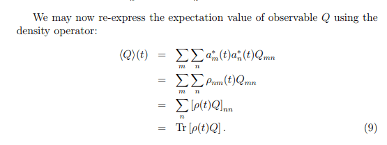

I've still no clue, what's the meaning of the formula ##\langle A \rangle=\mathrm{Tr}(\hat{\rho} \hat{A})##, if it's not an averaging procedure? It doesn't need to be an ensemble average. You can also simply "coarse grain" in the sense you describe it, i.e., averaging over "microscopically large, macroscopically small" space (or space-time) volums. This is in fact what's effectively done in the gradient expansion.
Of course, another argument for the gradient expansion as a means to derive effective classical descriptions for macroscopic quantities is that it can as well be formalized as an expansion in powers of ##\hbar##.
I also don't see a problem with the treatment of a single system in standard quantum theory within the standard statistical interpretation of the state since, whenever the classical approximation is valid, the standard deviations from the mean values of the macroscopic observables are irrelevant (that's a tautology), and then the probabilisitic nature of the quantum state is simply hard to observe and everything looks classical.
Take the famous ##\alpha##-particles in a cloud chamber as an example a la Mott. Each single particle seems to behave classical, i.e., following a classical (straight) trajectory, but of course it's because it's not a single-particle system at all, but a single particle interacting (practically continuously) with the vapor in the cloud chamber. The macroscopic trajectory, for which you can in principle observe position and velocity of the particle on macroscopic level of accuracy by just observing the trails building up during the particle is moving through the chamber, is due to this interaction "with the environment". For a single ##\alpha## particle in a vacuum originating from a single ##\alpha##-decaying nucleus you cannot say too much indeed: You neither know when it's exactly created nor in which direction it's flying, while all this is known simply by observation of the macroscopic trails of the ##\alpha## particle in the cloud chamber.
It's a property of the system like angular momentum in Classical Mechanics.
But you defined it in your lecture notes as being the average over the ensemble of all systems prepared in the state ##\rho##. Since you now claim the opposite, you should emphasize in your lecture notes that it does not need to be an ensemble average, but also applies to a single, uniquely prepared system, such as the beautifully and uniquely shaped lump of silver under discussion.
In my view, the meaning of the formula ##\langle A \rangle=\mathrm{Tr}(\rho A)## is crystal clear. It is the trace of a product of two Hermitian operators, expressing a property of the system in the quantum state ##\rho##, just like a function ##A(p,q)## of a classical Hamiltonian system expresses a property of the system in the given classical state ##(p,q)##.
Ostensibly, ##\langle A \rangle## is not an average of anything (unless you introduce additional machinery and then prove it to be such an average). If the Hilbert space is ##C^n##, it is a weighted sum of the ##n^2## matrix elements of ##A##, with in general complex weights. Nothing at all suggests this to be an average over microscopic degrees of freedom, or over short times, or over whatever else you may think of.
Of course, I've defined it in this way, because it's most easy to derive the formalism from it. Also the mass is indeed crystal clear, but to do physics you need to know the meaning of the procedure to real-world observables. So still, if ##\langle A \rangle## is not an average, I don't know what it is and how to apply it to the real world.
Obviously you simply don't understand the argument, why the formal manipulations used to derive macroscopic (classical) behavior, be it from quantum or classical statistical physics, always is an averaging procedure over many microscopic degrees of freedom. That all started from the very beginning of statistical mechanics by Bernoulli, Maxwell, and Boltzmann. It has also been used in classical electrodynamics to describe the intensity of electromagnetic fields, particularly optics (where the averaging is a time average), the derivation of electromagnetic properties of matter from classical electron theory (where the averaging is over spatial cells) by Lorentz et al. The same holds true for hydrodynamics (local thermal equilibrium and the corresponding expansions around it to yield all kinds of transport coefficients). All this is completely analogous in Q(F)T. It's the same basic understanding of the physics underlying the mathematical techniques which indeed turned out to be successful.
So it seems as if the Thermal Interpretation is just the "shut-up-and-calculate interpretation" pushed into the extreme, such that it's not useful anymore for the (phenomenological) theoretical physicist. I've some sympathies for this approach, because it avoids philosophical gibberish confusing the subject, but if you don't allow heuristic thinking (like the extremely useful idea of the Gibbs ensemble), there's no chance to apply a theory to new physical problems in the real world.
By your (i.e., the conventional minimal statistical) definition, it is an average over the ensemble of equally prepared systems, and nothing else.
How to apply it to the real world, e.g., to a single beautifully shaped lump of silver or to hydromechanics, should be a consequence of the definitions given. If you interpret it as another average, you therefore need to derive it from this original definition (which is possible only in very special model cases). Otherwise, why should one believe you?
