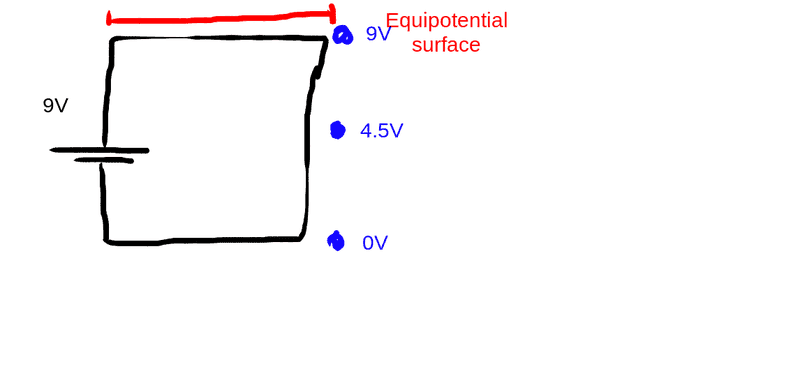

So basically, I am inferring the following based off of what I've learned.
When we hook a battery up to a circuit, this creates a potential difference. Say we use a 9V battery. Here is a picture:
From what I know, the horizontal is a equipotential surface, and the vertical has different voltages associated with different points. For example, the top point is 9V, middle 4.5V, bottom 0V.
I have some questions:
(1) Now, let's assume we placed a capacitor on the circuit in the position of the 4.5V dot. Then why do we say the voltage across the capacitor is 9V? Shouldn't the voltage across the capacitor be very tiny, depending on the capacitors size? I.e., the voltage at one plate minus the voltage at the other plate? This certainly wouldn't be 9V.
(2) When we have electrical components on the circuit- why is it that we can say they consume voltage and cause a voltage drop? Isn't this impossible? Isn't it defined that the top is 9V, the bottom is 0V. Therefore, shouldn't it be impossible for this voltage to drop, unless we change the batteries voltage?
(3) If the red line is an equipotential surface, exactly what encourages the current to flow? Is it that the electrons will gather up along this equipotential surface, and eventually end up repelling each other? Thus causing the current to flow?
That's incorrect ... Why would you think that ?
You have not indicated the presence of a resistor, so assuming you are indicating a normal piece of copper wire, there will be a short circuit across the battery and the voltage will be zero or something close to it
incorrect ... see my comments above
No, we don't say, "they don't consume voltage".
again, refer to my above comments
no ... again refer to my first commentsDave

X86:
Have you really thought about the definitions of potential and voltage? You seem to be mixing the concepts.
wikipedia said:
An electric potential (also called the electric field potential or the electrostatic potential) is the amount of electric potential energy that a unitary point electric charge would have if located at any point of space, and is equal to the work done by an electric field in carrying a unit positive charge from infinity to that point.
Nobody is going out to infinity to make that measurement for us.
So we always use the difference of potential between two local points.
That's the definition of voltage, potential difference between two points..
So whenever you state a voltage you must make it clear between what two points.
I wouldn't say that at all.
A capacitor has two ends not one. Where do they go? You only mentioned one place. It takes two places to have a potential difference.
I think your questions will answer themselves when you get your basics straightened out.

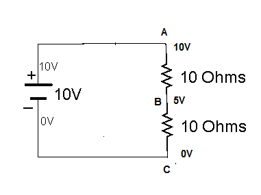

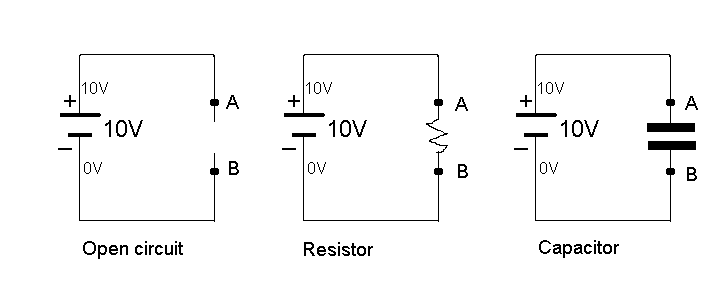

The ONLY way you would get voltage reading like you have indicated would be if you had 2 resistors of identical value in series between the positive and negative terminals of the battery
like this ...
so ...
--- if you put the negative lead of your voltmeter at point C and the positive lead on point A, you would measure 10V
--- if you put the negative lead of your voltmeter at point C and the positive lead on point B, you would measure 5V
--- if you put the negative lead of your voltmeter at point B and the positive lead on point A, you would measure 5V
5V is dropped across each resistor
This is called a voltage divider. if the resistances are identical, the centre voltage at point B will always be 1/2 the full supply voltage
if the resistor values are different, then the voltage at point B will be some value relating to the voltage drops across each resistorDave
Likes x86
Now there is one proviso (caveat) to this
I won't mention it yet and confuse you, I want to make sure you have got the basics that Jim and I have stated above
once those are sorted I will comment on the other "option"
Dave
Likes x86

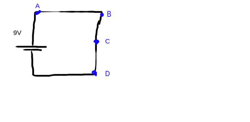

I think after reading the above posts, I now understand where my confusion was coming from. I know that voltage is potential difference (we must measure the potential in regards to two points)
But I'm a little confused about one concept regarding the below circuit diagram:
a) What is the potential difference betwen A and B? Isn't it zero, because it's an equipotential surface?
b) What is the potential difference between B and C?
c) What is the potential difference between B and D?
I'm thinking b and c have the same answer, but this is kind of confusing to me, because they have different lengths.
This also kind of relates to my capacitor confusion. If we put a capacitor at C then the potential difference between its plates will be 9V. But why? This part confuses me, because it feels like B--->C should have a different potential difference than B--->D (related to the wire length)
hi x86
Am not sure why you are still confused ? did you study that circuit I posted with the 2 resistors ?
did you not understand the text I posted at the top of my first reply ?...
You have not indicated the presence of a resistor, so assuming you are indicating a normal piece of copper wire, there will be a short circuit across the battery and the voltage will be zero or something close to it regardless of which points you measure between
in your latest diagram, there is no difference between any of those points ( when dealing with a length of copper wire a few metres or so long )IM thinking your confusion stems from the fact that part of the wire is level and part if vertical ... is that correct ?
if so you are making incorrect assumptions :wink:

Yes. I did read your above post. I am just confused about the voltage between different points in the above diagram (copper wire only).
I still don't understand what you mean by "there will be a short circuit across the battery and the voltage will be zero or something close to it."
My confusion is stemming from being unsure what the potential difference in a battery hooked up to a copper wire is, at different points.
For instance, let's say that A and B have different potentials (somewhere in space). Then their potential difference is B-A
But how does this relate to the circuit? Now the points A,B are no longer in space, but on the circuit. I know the battery provided potential difference. But I'm confused about the potential difference on different parts of the circuit.

have a look at this pic I drew ...
The voltage measured between points A and B in any of those 3 circuits will ALL be 10V

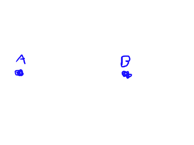

A question well stated is half answered.
You are sending us mixed messages.
Your horizontal wire AB you say is an equipotential surface.
Then you say your vertical wire is not an equipotential surface.
What is the difference between those two wires? Electric potential is unaffected by gravity.
If there is no potential difference between A and B there'll be no current flow from A to B.
If AB BC and CD are all made from the same kind of wire, and are as near the same length as they appear in your drawing,
then why do they (edit have) behave so differently when connected in series?
In circuit analysis we usually assume our conductors to have zero resistance hence zero voltage drop.
But we remain aware that's an exaggeration, in actuality there is small voltage required to push current along a wire.

Thank you guys for being so patient with me, and I am sorry for sending mixed signals. After pondering for a while, I've realized that I've been unnecessarily overcomplicating the problem. Let's assume the circuit is a superconductor and the wire has a resistance of 0 V.
You are correct, I am confused about the fact that some of the wire is level and some of the wire is vertical. I was told that in circuits, the level wire will always be an equipotential surface, and that the vertical wire will always have a voltage equal to that of the battery. I do not understand why this is the case. The only thing that I know is that it will take 9J of work to move a charge of 1 C from the (+) terminal to the (-) terminal. Everything I said in my first post were things that I think, not necessarily things that are true.
That is totally incorrect and no wonder you were getting confused with our responses.
think about the wiring in just about any electronics ... inside a TV, a computer, a car, a plane
the wiring curls all over the place as it makes its way from power sources to control panels/displays to the sensors etc being controlled.
The potentials are not affected by that at all. What affects the voltage drop on a wire is its length.
As the wire gets longer, its resistance increases and this produces a voltage drop

Yes. Current is how a positive charge would flow in the circuit. It moves from high potential to low potential, whereas electrons move from low to high potential. Of course, the only thing flowing is electrons, so current seems like something more imaginary. In my example above, I was referring to an imaginary +1C charge.
That is good drafting procedure to draw them that way and nothing more.

The problem with the OP (and diagram, in particular, is that it assumes ideal components (without extra information) and so it is an impossibility. Bad start for a technical discussion. A real battery will have internal resistance and so will a real wire so the 9,4.5,0 figures make assumptions about the nominal battery collage (emf) and the resistance of the components (including wire).
Equipotential Surfaces are very hard to define in circuits with ideal conductors because the potential is the same all over any particular wire and undefined in the space around. Using the term just makes a discussion more difficult. You will notice that circuit theory books don't do it that way -= for a good reason.
Likes x86
You also missed the point that got clarified earlier that x86 thought that the horizontal section was equipotential and the vertical section of the circuit had the voltage drop corresponding to the figures on that circuit that you quoted
This is of course incorrect and got sorted out :wink:Dave

sophiecentaur said:
I take your point - to some extent. But I can't find any statement to the effect that the concept of equipotential surfaces has no place in (normal) circuit theory.
you still misunderstand :wink:
Its a circuit drawing, he thought the horizontal parts of the drawing were equipotential and the vertical parts defined a voltage drop
This as I said is totally incorrect ... its just the way circuits need to be drawn
Its JUST a drawing, a bunch of lines, connecting a collection of components :smile:Dave

I don't misunderstand. I just make the point that people could read this thread and not realize what you and I know - because the concept of equipotential lines is totally misplaced here.
This (anonymised) post :
"do really voltmetres measure joule required to move a coulomb of charge?" shows the possible level of confusion that the thread can be generating.
But you and I agree, obviously, on the facts.

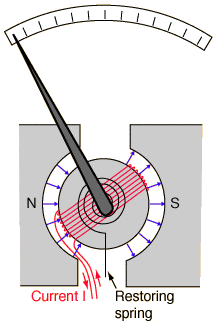

That question really interested me - i was trying for days to figure out an answer.
As Mr Sophie said, the plain vanilla everyday meter measures how much current an unknown voltage pushes through a known resistance.
http://hyperphysics.phy-astr.gsu.edu/hbase/magnetic/galvan.html
Microamps flowing through the red coil create torque.
The needle deflects until the torque from current just balances the torque from the spring.
The scale is marked in volts rather than micro-amps.
You'd switch in various series resistor values to make a multi-range voltmeter.

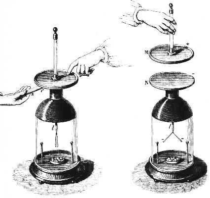

An electroscope can measure charge...
http://physics.kenyon.edu/EarlyApparatus/Static_Electricity/Electroscope/Electroscope.html
The two electroscopes below are equipped with the bottom plate of Volta's condenser. The upper plate is of the same dimensions as the lower one, and has an insulating glass handle attached, and its lower surface is covered with varnish for insulation.
The condenser allows small quantities of charge to be detected. It is charged by touching the object under test to the lower plate, while grounding the top plate. If the lower plate has been positively charged, negative charge will be transferred to the upper plate. The ground connection is then broken, followed by disconnecting the test object. The capacity, C, is then decreased by lifting up the upper place. Since the potential across the capacitor, V, is related to the constant charge Q by Q = CV, the potential increased and the electroscope leaves diverged.
REF: Thomas B. Greenslade and Richard H. Howe, "A Modern Use of Volta's Electroscope", The Physics Teacher, 19, 614-615 (1981)
Now it strikes me that the act of separating the plates involves overcoming the attraction between them
so in principle one exerts some minute amount of Newton-meters in that experiment.
