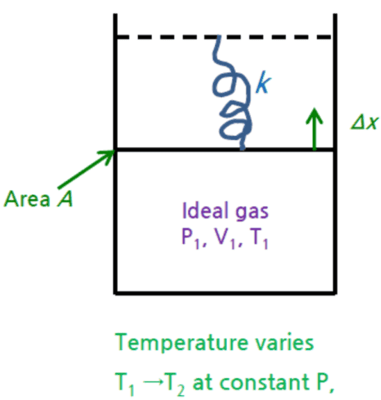

Confusion between adiabatic and energy
In summary, irreversible processes involve changes in internal energy, work done against the environment, and entropy. Adiabatic processes, where there is no energy or matter transfer between boundaries, can still involve work done against the environment through expansion or compression. However, in irreversible processes, the ideal gas law cannot be used to calculate work as the pressure of the gas is not uniform spatially. This is due to the fact that the gas is not close to equilibrium in an irreversible process.
TimeRip496
254
Source: https://en.wikipedia.org/wiki/Irreversible_process
I think I can see it mathematically but it is not very intuitive to me as it seems like there is creation of energy?
For instance,
1) Adiabatic expansion
1st law of Thermodynamics to describe conservation of energy
(-dU) = dQ - W
where dU-change in internal energy, dQ-energy in/out the system, W-work done against the environment
(-dU) as internal energy of system decreases(temperature decreases) due to expansion
Since is adiabatic, dQ = 0, thus dU = W.
2nd law of Thermodynamics to describe direction of natural process
(-dU) = TdS - PdV1
TdS = (-dU) + PdV1
when the system is irreversible, dS > 0. For dS > 0, -dU + PdV1 > 0, thus PdV1 > dU.
Hence PdV1 > W and thus, TdS > Q.
Therefore, increase in entropy for adiabatic expansion.
2) Subsequently, when we compress it adiabatically
Again, 1st law of Thermodynamics to describe conservation of energy
dU = dQ - (-W)
-W as work on system due to compression
dU = TdS - (-PdV2)
TdS = dU - PdV2
when the system is irreversible, dS > 0. For dS > 0, dU - PdV2 > 0, thus PdV2 < dU.
Hence PdV2 < W and thus, TdS > Q.
Since PdV2 < W and pressure change is the same, dV2 < dV1.
Therefore, we cannot get back to the previous volume at the same temperature.
Adiabatic means that there is no energy/matter transfer between the boundaries right? The only thing that is allowed is work against environment through expansion or compression.
From my above, why won't the system be such that PdV = W especially since it is adiabatic? Entropy cannot decrease but it can remain the same which means the process can be reversible. The only reason I can think why PdV > W is that the system is not perfect as maybe there are friction? However won't that not be adiabatic? Where did that excess PdV - W comes from?

You can't use the ideal gas law to calculate the amount of work for an irreversible expansion or compression using dW=PdV (even if there is no friction) because, in such an expansion or compression, the pressure of the gas in the cylinder is not uniform spatially, so which pressure do you use in the integral? The fact of the matter is that, in an irreversible expansion, the gas is not close to equilibrium, so the ideal gas law (or other equation of state) does not give the correct relationship. In addition to the pressure not being uniform within the cylinder, the pressure at the piston face (where the work is actually done) depends not only on the current volume, but on the rate of change of volume (which is unknown).
There is enough informationin pictures you have provided to precisely calculate the conditions at the end of each step, and the exact changes in internal energy and entropy. If you'd like, I can help you determine these. Any interest?
Yes that will be great! I give it a shot but i doubt it is correct. Also for non-ideal work done, it is obtained through experimental data right?

Virtually all of this is incorrect. The reason is that the equations you have used are valid exclusively for an adiabatic reversible process, and we are dealing here with an adiabatic irreversible process.
To simplify things, what we are going to do in our analysis is to assume that the piston-cylinder system in the figures is situated inside a vacuum chamber (external pressure = 0) and that the piston in the figures is both massless and frictionless. These simplifying assumptions do not in any way change the key factor that we are interested in considering in our analysis, which is the irreversibility of the expansion and subsequent compression.
Based on these assumptions, if you do a force balance on the piston in the initial state of the system, how is the initial pressure ##p_1## (in State 1) related to the mass ##m_1##, the acceleration of gravity g, and the cross sectional area of the cylinder A? How is the pressure ##p_2## in State 2 related to the mass ##m_2##, the acceleration of gravity g, and the cross sectional area of the cylinder A? In terms of the mass ##m_2##, the acceleration of gravity g, and the change in elevation of the piston ##\Delta h##, what is the work W done by the gas on its surroundings (the piston) in the transition from State 1 to State 2?
We'll continue after you answer these questions.

$$p_1 = \frac{m_1g}{A}$$
$$p_2 = \frac{m_2g}{A}$$
Work done by gas on its surroundings, $$W=\frac{m_2g\Delta h}{A}$$
Likes Delta2
This last equation is incorrect. The correct expression for the work is ##m_2g\Delta h##, the change in potential energy of m2. So, for the work done by the gas on its surroundings in the transition between States 1 and 2, we have: $$W_{1,2}=m_2g\Delta h=\frac{m_2g}{A}(A\Delta h)$$But, geometrically, $$A\Delta h=(V_2-V_1)$$Therefore, $$W_{1,2}=p_2(V_2-V_1)$$Note that this equation differs from what you obtained by assuming that the ideal gas law is satisfied in all intermediate states occurring during the transition from State 1 to State 2. In an irreversible expansion or compression of an ideal gas, the ideal gas law is not satisfied during the process, since the system is not in thermodynamic equilibrium. It can only be applied to the two end states, where the system is in thermodynamic equilibrium. Therefore, since our two ends states are thermodynamic equilibrium states, we can write: $$p_1V_1=nRT_1\tag{1}$$ and $$p_2V_2=nRT_2\tag{2}$$
Applying the first law of thermodynamics to the transition between states 1 and 2, we have: $$nC_v(T_2-T_1)=-p_2(V_2-V_1)\tag{3}$$ If we next use Eqns. 1 and 2 to eliminate V1 and V2 from this equation, what do we obtain?
Likes Delta2
Oops sorry! I confuse the pressure with the force.
I obtain this,
$$T_2(1+\frac{C_v}{R})=T_1(\frac{C_v}{R}+\frac{P_2}{P_1})$$
Just to confirm, the Cv will be the specific heat capacity for the volume at V1 right?
Likes Delta2
TimeRip496 said:
Oops sorry! I confuse the pressure with the force.I obtain this,
Excellent! Now, see if you can re-express this equation as:
$$\frac{T_2}{T_1}=1-\frac{(\gamma-1)}{\gamma}\left(1-\frac{p_2}{p_1}\right)$$where ##\gamma=C_p/C_v=(C_v+R)/C_v##. Next, use the ideal gas law to determine the volume ratio ##V_2/V_1## for the change from State 1 to State 2, exclusively as a function of the pressure ratio ##p_2/p_1##
Now, do you know the equation for the change in entropy of an ideal gas in terms of the temperature ratio and pressure ratio between the initial and final states?
The internal energy of an ideal gas is a function only of temperature, and Cv is thus given by $$C_v=\frac{1}{n}\frac{dU}{dT}$$independent of the gas volume. So Cv is the same for all volumes of the gas. It is a function only of temperature.
Likes Delta2
Now, do you know the equation for the change in entropy of an ideal gas in terms of the temperature ratio and pressure ratio between the initial and final states?The internal energy of an ideal gas is a function only of temperature, and Cv is thus given by $$C_v=\frac{1}{n}\frac{dU}{dT}$$independent of the gas volume. So Cv is the same for all volumes of the gas. It is a function only of temperature.
The formula for change in entropy is
$$\Delta S = C_p ln\frac{T_2}{T_1} - Rln\frac{P_2}{P_1}$$
Now all I do is sub in the above temperature and pressure ratio to get the change in entropy.

This equation gives the entropy change per mole of ideal gas. You need to multiply by the number of moles to get the actual entropy change.
I think the really confusing part is doing the irreversible and reversible process differently. And how differently am I suppose to do It I have no idea. It will be easier if values are provided because I can see if the process is reversible by checking that the change in entropy is zero. But how do I go about doing with variables instead? Like what steps are used for reversible and what steps are used for irreversible process? Thanks!
So you are able to identify whether a process is reversible or irreversible. What characteristics of reversible vs irreversible are different?
I think the real problem is knowing how to analyze an irreversible process. Here is a Physics Forums Insights article I wrote which focuses on this: https://www.physicsforums.com/insights/grandpa-chets-entropy-recipe/
If you have any specific questions, please feel free to ask.

Are you familiar with the concepts of ideal springs and dampers (aka dashpots) in mechanical systems (a damper is essentially the same as a shock absorber in a car, where the force to extend the damper is proportional to the relative velocity of the two ends of the damper). If so, I think I can give you a better feel for reversible vs irreversible.
I am not familiar with damper but i am familiar with ideal spring.
Is this a good example to use?
