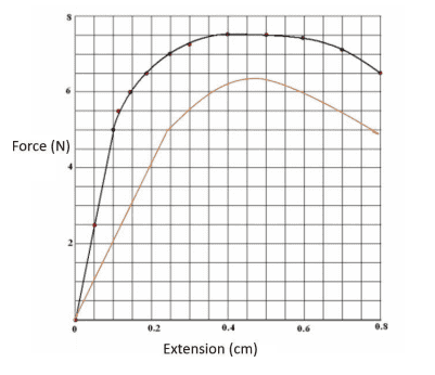

You narrow it down to two recipes. In the graph below are the two possible
options you produce when you hang weights from the bottom of your two
most likely gummy worms and measure the extension.
Calculate the Young Modulus of the gummy worms by converting one of the options
into a stress/ strain graph (to be shown with your answers) and the other by using
calculations. Choose which gummy worm you think would be better and explain why.
'Gummy 1' = Black Line
'Gummy 2' = Orange Line

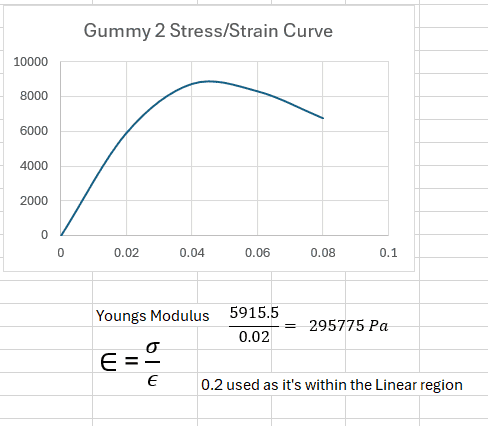

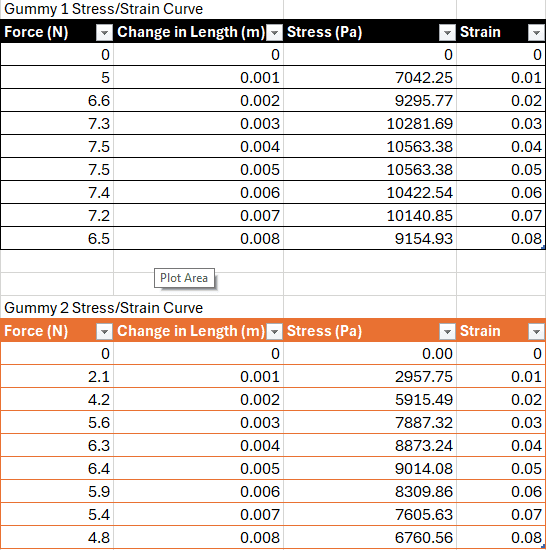

Using the diameter given and the force measurements on the vertical axis of the graph, I've worked out the cross-sectional area of the mold to be 0.000706858, which I've rounded to 0.00071.
Using this data and the equation Stress = F/A, I've calculated the Stress for each point on the graph 0.2, 0.4, 0.6 0.8.
For strain I've used the initial length (0.1m) noted in the question divided by the extension at each point, I've maintained the measurement in metres for simplicity. the two tables of measurements i've produced for these are as follows:
So from this, I have to calculate Young's modulus for one gummy using a graph and one from just calculations.

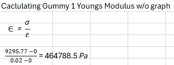

Gummy 1:
I used 0.2 again as it's my first value in my table, another point of confusion for, how do I know that this is within the linear region of the graph? It
Gummy 2 with Graph.

One thing is to estimate the Young's modulus of each recipe, and another is to create its stress–strain curve.
For the former, you should only use several points within the linear (purely elastic) region of the graphs or data.
Copied from
https://en.wikipedia.org/wiki/Young's_modulus
"Young's modulus is defined as the ratio of the stress (force per unit area) applied to the object and the resulting axial strain (displacement or deformation) in the linear elastic region of the material."
Likes Chestermiller
AndrewsRT_16 said:
I understand that you use the equation Young's Modulus = Stress/Strain for some point within the linear region of the graph
So why did you not do that? Linear region means where it is a straight line. For Gummy that is for extensions up to 0.1cm, but the shortest extension in your table is 0.2cm.
Yeah, I see what you're saying, it doesnt make sense to use 0.2cm onward. I did try to use stress/strain values at 0.1cm intervals but after coming up with the answers, I somehow convinced myself it wasn't right and decided to use 0.2 instead. Thanks for pointing that out.

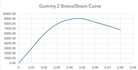

I've redone the tables with values from 0.1 - 0.8 and so far this is what I've got.
So for the first Gummy, the only extension value within the Linear elastic region is 0.1cm (on the table)
The Youngs Modulus at this value should be:
7042.25 / 0.01
= 704225 Pa

As for Gummy 2, both 0.1 and 0.2 cm are within the linear elastic region, the new graph looks like this.
As I calculated previously the value at 0.2cm extension is:
5915.5/0.02 = 295775 Pa
Now with the value of 0.1cm:
2957.75/0.01 = 295775 Pa
That seems to confirm that's the correct value.
Looking back at my conclusion I still think it remains the same, the second option is more suitable for the stand. The first option appears too stiff and inflexible, requiring much more applied stress to deform a similar amount to the second option, it generally wouldn't be a good choice for a gummy.
