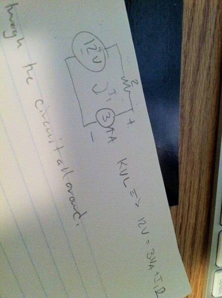

Given the this circuit calculate the voltage through the 3amp source? attached is a jpeg of the circuit. I wasn't able to get a good score on this one question quiz since this boggled me. Is true if I put current source that it will dictate the current of the battery?
Hi, I am having some trouble analyzing this circuit.
Kirshhoff's Voltage Law.
There is only one mesh for this circuit(square box). I have three components a 12 volt battery, a resistor and a 3amp current source. I want to find the voltage of the 3 amp current source. I found the equation for the loop (clockwise) to be 0 = 12 -i2 - (voltage of the 3 amp current source). How can I solve this with 2 unknowns. My professor said that the key to solving this was ohms law, the i through the 2 ohm resistor is 3 amps and thus the voltage for the 2ohm resistor is 6V and thus we can see that i2 = 6V so 0 = 12 -6 -(Voltage of the 3 amp current source) would then yield 18 as the voltage through the 3amp source. I know however from very basic circuits that the voltage source would produce a current so why can he just say that the 3 amp source is equal to the current produced by the battery?
For this circuit, yes.
The job of the voltage source is to produce and maintain its specified voltage across its terminals without regard for the current going through it.
The job of the current source is to produce and maintain its specified current through its terminals without regard for the voltage appearing across it.
The key is to realize that if the current source is doing it's job, then 3A will be flowing through all the components of this circuit (in a counter-clockwise direction). So your I1 is known (-3A).
The current source has to produce a voltage = the voltage across the resistor + voltage of the voltage source.
An ideal voltage source can sink current as well as source it.
okay, I didnt know that. Thank you lewando.Your explanation makes sense, but let's say that its just a resistor, the 2ohm, the current would then be 6 amps by ohms law but that's because there is a current coming from that battery. you see my dilemna? please explain further. What happened to that current? How do i remember that the current source would take precedence over the current source of the battery?

For a battery in series with the resistor, this is true. The voltage source is still acting like a voltage source. The thing that determines the current is the voltage of the battery and the value of the resistor. If the value of the resistor changes, so will the current--so in that sense the voltage source is providing current but it is not acting like an actual "current source".
you see my dilemna? ... What happened to that current?
If your dillemma is a battery is not a current source, but can be source of current, I can see how the wording can be confusing. Remember, a battery can also be a sink of current (as NascentOxygen pointed out--like when it is being charged). What happened to the current is that a current source was installed which has the job of making sure that a fixed amount of current is going through it. For amusement purposes let's say a 0A current source was installed (also known as an open circuit) The 6A prior to the installation simply becomes 0A. This is due entirely to a change in the configuration of the circuit.

Just remember that a battery is not a current source (per the strict definition of a current source).
Edit: Perhaps it will be more clear to use the terms constant current source and constant voltage source. So a battery is not a constant current source, although it can be a source or sink of current, depending on the circuit in which it is installed.

You could say that. It does whatever it has to do to make 3A go through it. Since the circuit is a series circuit, all elements will have the same current.

The voltage divider rule is used for a voltage applied across 2 resistors in series, so since the constant current source is not a resistor you can't use it.

The current source sets the loop current to be 3 amps. End of story.

"voltage source of the 2 ohm resistor"? :confused: Did you mean to type "voltage across the 2 ohm resistor"?
Use ohms law. It's a 2 ohm resistor and has 3 amps flowing through it, so the voltage across the resistor alone is 6 volts.
As I pointed out earlier:
Code:
