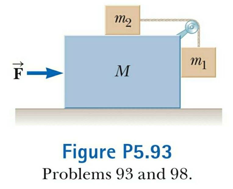

Initially, the system of objects shown in Figure P5.93 (see attached) is held motionless. The pulley and all surfaces and wheels are frictionless. Let the force F be zero and assume that ##m_1## can move only vertically. At the instant after the system of objects is released, find (a) the tension T in the string, (b) the acceleration of ##m_2##, (c) the acceleration of M, and (d) the acceleration of ##m_1##. (Note: The pulley accelerates along with the cart.)

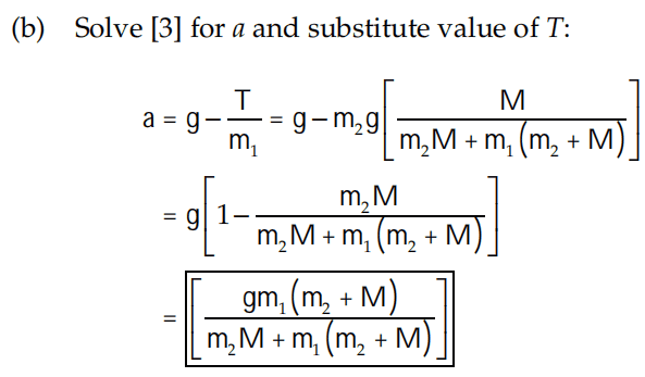

I'm having trouble understanding the solution my professor gave me, in particular, the accelerations of m_2 and m_1. When my professor solved for the acceleration of m_2, he used a as the acceleration but when I look at the second law equation for m_2 as shown in eqn. [1], it's a-A. Likewise, when he solved for the acceleration of m_1, he used a-A as the acceleration when according to eqn. [3], it says a. Is this just a simple error on his part or am I misunderstanding something?

niko_niko said:
Homework Statement: Initially, the system of objects shown in Figure P5.93 (see attached)
Where?
Is this the proper figure?
haruspex said:
Where?
Forgot to attach sorry. Here it is.
Yes, that is also what my professor showed me.
I assume that means vertically relative to M.

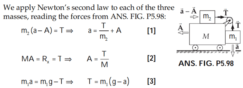

When my professor solved for the acceleration of ##m_2##, he used ##a## as the acceleration but when I look at the second law equation for ##m_2## as shown in eqn. [1], it's ##a-A##.
How did your professor define a, as acceleration in the ground frame or relative to M?
Well, looking at the second law equations he wrote, I would assume a is measured relative to the ground given that it took into account the acceleration A of the cart. But when he solved for the acceleration of for item (b) he seemed to only use a, as shown in the image below.

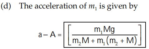

If a is the magnitude of the vertical component of the acceleration of the suspended mass then it is also the acceleration (to the right) of the top mass relative to the block. (Using the constancy of rope length.) If the acceleration of the block is A to the left then the top mass's acceleration to the right in the ground frame is a-A.
So in that case, the solution provided for (b) should be the acceleration for the hanging mass and not the top mass. Am I correct?
No. (b) asks for 's acceleration. Since it does not specify relative to the block M, you should take that as acceleration in the ground frame, a-A.
haruspex said:
No. (b) asks for ##m_2##'s acceleration. Since it does not specify relative to the block M, you should take that as acceleration in the ground frame, a-A.
But in the solution provided for (b), my professor used a instead of a-A. Likewise, in (d) the acceleration for the hanging mass was a-A according to the solution.

Did your professor really write those 3 equations as they are written?
Yes. Those are the exact equations that were provided. For reference, I attached the solution my professor gave me containing those equations.

Let represent the acceleration of the large block in the positive x direction, and "a"represent the downward acceleration of m1. Then "a" is also the horizontal acceleration of m2 relative to M, and the absolute horizontal acceleration of m2 is ##(a_B+a)##. OK so far?
First, the solution shows I guessed wrongly about "m2 only moves vertically". It means that in the ground frame.
Given that, the expression found for is correct, but it is not the acceleration of the top block in the ground frame.
Looking now at the solution to (d), it seems the solver has become confused between the two masses, as you suspected. The answer to (d) should be the expression found for and the answer to (b) should be .

I'm just going to say it. I don't think the solution provided is correct. If can only move in the vertical direction it must be restricted by a track of some sort. That track is essential for providing the force that pulls along in the horizontal direction. As a direct consequence of Newtons 3rd there is a force that has not been accounted for acting on the large mass in the solution provided by the prof.
erobz said:
I'm just going to say it. I don't think the solution provided is correct. If ##m_1## can only move in the vertical direction it must be restricted by a track of some sort. That track is essential for providing the force that pulls ##m_1## along in the horizontal direction. As a direct consequence of Newtons 3rd there is a force that has not been accounted for acting on the large mass ##M## in the solution provided by the prof.
If F=0 and the cart is moving to the left, then m1 doesn't contact M.
A track is not required. Nor, according to the givens in the problem, can a track (attaching to ) be present.
We are only asked for initial forces and accelerations. Initially, the only forces acting on are vertical. Accordingly, the initial acceleration of will be purely vertical. The proviso in the problem statement is not needed.
If, counterfactually, there were a track constraining to follow the face of , then, because accelerates leftward, so would . This would violate the givens of the problem statement which state that moves vertically only.
It would be possible for to be mounted on a vertical guide track anchored to the ground without violating the givens of the problem. This would not "pull along in the horizontal direction" since is stipulated not to move in the horizontal direction. However, since such a track would, at least initially, exert zero force on , it would be redundant.

I shall refer to as the top block for convenience. As for the horizontal acceleration of the top block relative to the ground frame, it should be . However, as I have said, the solution says it is simply . As for which I shall refer to as the hanging block, the solution states that it's acceleration is , however this can't be the case because the hanging block moves only vertically so the acceleration A of the cart must not be relevant for the case of the hanging block. Please see the solution for (b) and (d), I do not want to post it for the third time.
  • #33
niko_niko said:
I shall refer to ##m_2## as the top block for convenience. As for the horizontal acceleration of the top block relative to the ground frame, it should be ##a-A##. However, as I have said, the solution says it is simply ##a##. As for ##m_1## which I shall refer to as the hanging block, the solution states that it's acceleration is ##a-A##, however this can't be the case because the hanging block moves only vertically so the acceleration A of the cart must not be relevant for the case of the hanging block. Please see the solution for (b) and (d), I do not want to post it for the third time.
Let me go back and review the proffered solution with which I think you disagree.
So contrary to your assertion is taken as the vertical acceleration of on the right. Not up top.
is then the horizontal acceleration of up on top. Just as you agree it should be. The pulley is accelerating leftward while block is accelerating rightward.
The rate at which the length of horizontal cord is shortening is given by an acceleration rate of . The rate at which the length of vertical cord is lengthening is given by an acceleration rate of . This consistency check passes!
Note that mass will be remaining horizontally in place while mass moves away to the left. From the point of view of the accelerating rest frame of , mass will be swinging horizontally away.
Are we in agreement so far?
If we examine the equations, we have: The acceleration term is relative to the ground frame. We have no inertial pseudo forces to account for. The only horizontal force on is T. So that equation is fine.
We also have: That is, the net downward force on is the downward force from gravity plus the upward force from tension. That seems straightforward enough.
What is your objection?

What I see here is a formula for (b) that evaluates to which you have agreed is the acceleration of . However, (b) was supposed to be about the acceleration of .
I suspect that it is a correct answer for (d). Though I have not verified the formula.
What I also see here is a formula for (d) that evaluates to which you have agreed is the acceleration of . However, (d) was supposed to be about the acceleration of .
I suspect that this is a correct answer for (b). Though I have not verified the formula.
