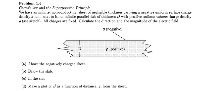

In summary, the conversation is about a broken snipping tool and a question regarding problem 1.6 on a physics assignment. The equations involved are E_{sheet}=\frac{σ}{2ε_{0}}, E_{slab}=\frac{ρD}{2ε_{0}}, and \frac{Q}{ε_{0}}=\ointEdA. The person asking the question is confused about the positive and negative signs for regions I, II, and III on the Esheet and seeks clarification. Another person suggests considering the problem from a flux perspective and mentions using 3 equations and 3 unknowns.
JYangQi00
My snipping tool is totally broken. So I'm going to leave a link :x
It's problem 1.6
http://ocw.mit.edu/courses/physics/8-02-electricity-and-magnetism-spring-2002/assignments/ps1a.pdf
[itex]E_{sheet}[/itex]=[itex]\frac{σ}{2ε_{0}}[/itex]
[itex]E_{slab}[/itex]=[itex]\frac{ρD}{2ε_{0}}[/itex]
[itex]\frac{Q}{ε_{0}}[/itex]=[itex]\oint[/itex]EdA
I got everything on the solutions page (http://ocw.mit.edu/courses/physics/8-02-electricity-and-magnetism-spring-2002/assignments/pss1.pdf) But I can't seem to understand why region I of Esheet is positive and Regions II and III are negative. If σ is a negative charge, shouldn't the signs be switched around?
It's interesting that you have Gauss's Law as one of your equations. When taking a look at the plane, have you thought about it from a flux perspective?

Here is an image of the problem:
Post #2 is a good hint, follow it!
3 equations, 3 unknowns, 3 gaussian surfaces.
Hint: make sure two of them line up correctly!
