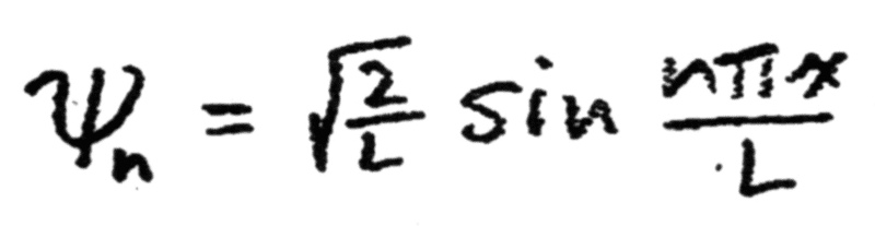

The formula I am given in my notes is:

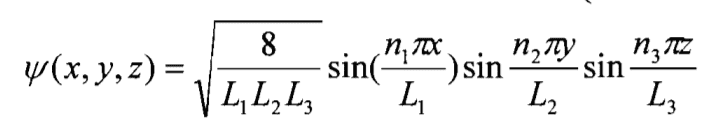

I found a website which explains this problem, and they give this formula:
But then, their answer is:
And I don't see how they went from sqrt(8) to 2 on the numerator. I am confused which formula to use where.

You have found a solution for the 3D problem. Yours is the 2D problem, which is slightly different.

Could I use this one:
and then add the y-component somehow ?

You've found the 1D solution and the 3D solution. I think you are supposed to solve the 2D problem for yourself!

Yes, your problem in 2- or 3 dimension is separable. That, is the wave function for the 2-dimensional problem can be written as a product of two wave functions, one depending on ##x## and the other on ##y##.
