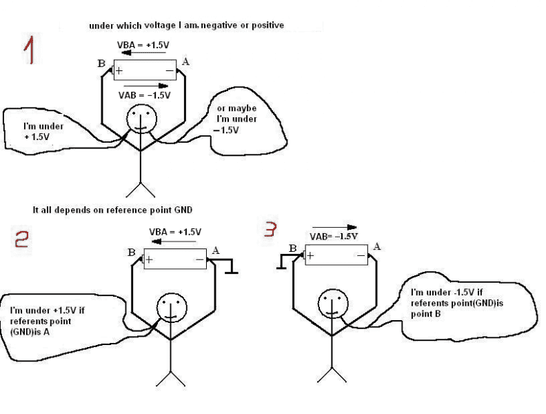

Because 24V voltage source has a positive terminal connected to gnd and the minus terminal to 6 ohm resistor.
And this is why voltage at right side of a 6 ohm resistor is -24V ( 24 voltages lower than voltage at GND).
The reference point determines whether we have a positive or negative voltage.
See this example
Does this apply regardless of the direction of the current(s) ?
In this case the current direction doesn't matter here. Because only the voltage source and the reference point (GND) determines the voltage polarity.
And this is why we have -24V and 60V regardless of the direction of the currents.
