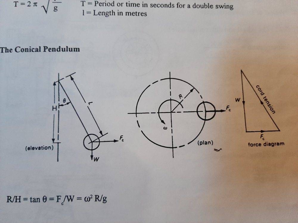

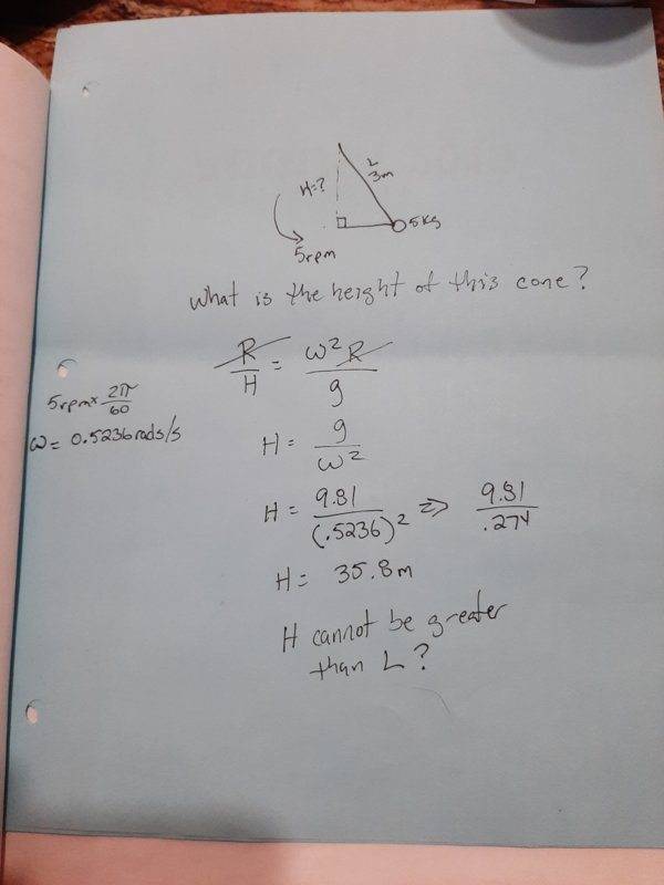

A 3m long string is attached to a 5kg mass and rotates at 5 rpm. Calculate the height of the pendulum.
H=g/w2 (Height = gravity divided by angular velocity squared)
= 9.81/ .27415 = 35.78m
So in this instance height is longer than the 3m string which is impossible. Do we just say that when ever H>L, H=L?
I suspect that the given values for this problem are incorrectly specified for a real solution to exist. Consider that at 5 rpm the bob would have a period per revolution of 12 seconds. The same setup but swinging like a normal (planar) pendulum would have a period of
$$2 \pi \sqrt{\frac{3 m}{g}} \approx 3.5 \text{ seconds}$$
Pretty sure the period of the conical pendulum should be less than or equal that of the planar version (haven't proved this yet, so it's just intuition at the moment).
I know the formula is correct as is the math...just must be missing some sort of rule?
Yes, the period of the conical pendulum is ##T=2\pi \sqrt{\frac{h}{g}}## where ##h## is the "height". Since ##h < L##, it is less than that of the planar pendulum unless, of course, the bob isn't moving.
Makes sense, thank you so much!
I find that the criteria is
$$L \omega^2 \ge g$$
else r becomes either zero or imaginary.
Yes. Circular motion can be decomposed as a superposition of linear harmonic motions at right angles with a 90-degree phase shift. In the limit of small angles for the conical pendulum, the harmonic motions are just pendulum swings of small amplitude which we know have angular frequency ##\sqrt{g/L}##. You cannot make the conical pendulum have a smaller angular frequency than this.
