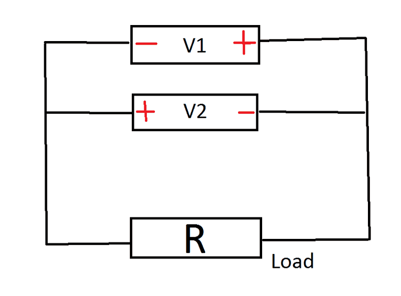

I would like to do now (theoretically) a couple of rather naive things with two batteries with voltages ##V_1## and ##V_2## in parallel charged with an abstract load with resistance ##R##.

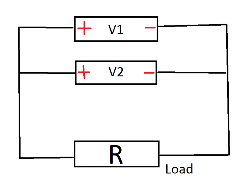

Usually, one learns in elementary electronics that the only "right" configuration with batteries in parallel is given by (M1), at least in case ##V_1=V_2##:
Now the story becomes weird. What is the precise physical explanation why following configuration causes damage where we swap the poles, or asking differently how to model the system's behavior in following case - call it (M2):

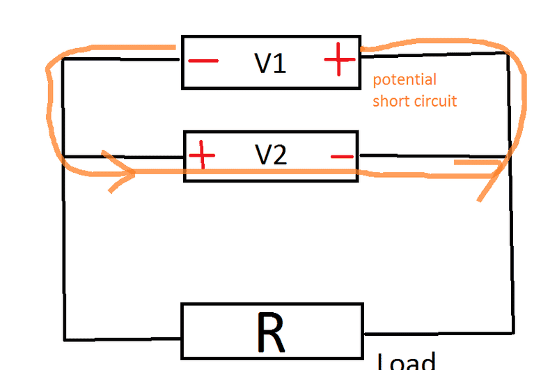

The "layman argument" which I often read but which not persuades me is that it causes short circuit in this area:

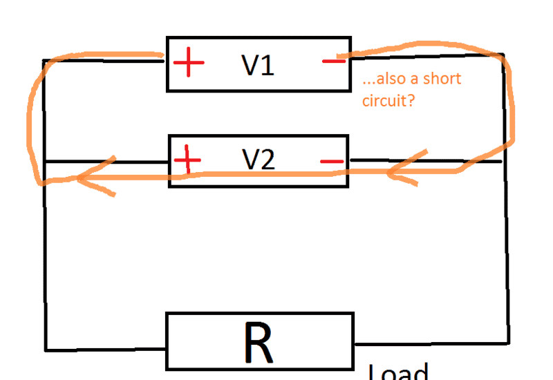

Well, but applying the same "logic" one could also say that there is also a short circuit
in (M1), or not?

Why this "short circuit argument" is valid for (M2), but not for (M1).
Therefore up to now I'm not happy with this way of reasoning, but maybe I'm missing the whole point. Can this argumentation refute my objection that seemingly the same reasoning may be naively thinking applied to (M1), too? What is the precise difference in the two cases? In other words, why connecting poles in "right" way - as in (M1) - not causes a short circuit - but (M2) does?
If this "Dr Google argumentation" is indeed too sloppy, is there a reasonable advanced argumentation explaining why configuration in (M2) damages the system? Is there a reasonable mathematical model predicting such behavior? Possibly, is it sufficient to reasoning with Kirchhoff's junction and voltage rules in naive way or does one need more advanced techniques from electrochemistry to answer the problem qualitatively satisfactory?

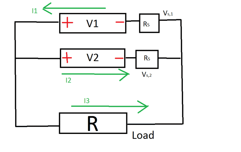

You need to think about the accurate models of the batteries. Each is modeled by the zero-source-resistance voltage source in series with some ##R_s## source resistance. To the extent that the source voltages are different (worst case reversed like you mention, less worst case but still problematic if they are paralleled with slightly different battery voltages), you will get fault currents flowing that depend on the voltage difference and the respective ##R_s## values.
Those fault currents generate heating in those batteries, which can cause fires and the exploding batteries that I mentioned.

Yes, that's the issue. I'm wondering what kind of model one should looking for "profound" enough to predict such behavior, not "too complicated" in order to be computable at all.

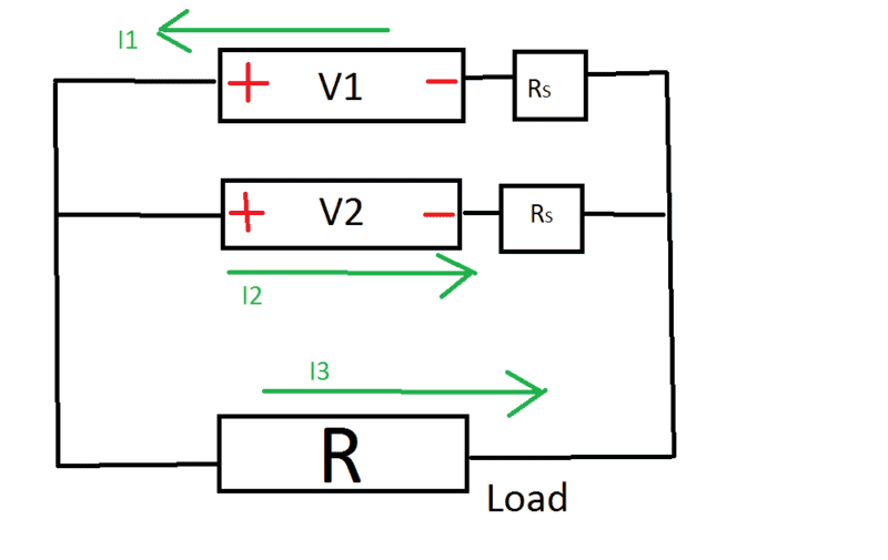

Okay, say we add too each battery a small resistence ##R_s##, so replace (M1) by
and apply Kirchhoff rules to voltages and currents. Respectively the same game for (M2) except that we change ##V_1## by ##-V_1##, ie with opposite sign.
Does this model already suffice to model the batteries to predict the behavior, or do we need something more advanced?

No, @berkeman does not mean ##V_1=V_2=12V##; he says they differ by ##0.5V##. So for example, set ##V_1=12V## and ##V_2=11.5V##, apply Kirchhoff's laws and see what you get.

Let's try in some more layman terms.
Ignore the R (load) for now, you connect just two batteries.
Current flows form + to - (let's not get nitpicky about the details).
If you connect the batteries in parallel (+ to +, - to -) each of them tries to put some current into the circuit, but as they are opposed, nothing happens.
If you connect batteries + to -, they each put highest current they can into the circuit, heating everything till the chaos starts.

Model each battery as a voltage source ##V_s## in series with its internal resistance ##R_s##.
The Tortoise-Man said:
Thanks for the correction. Ok, before I perform the standard calculations, is it correct that - except from my misinterpretation with ##V_1## and ##V_2## (...so let assume##V_1=12V## and ##V_2=11.5V##) - that else @berkman's suggested configurations are adressed to the model in the picture in #3, ie each of the two wires with a battery ##V_i## carries also a resistance ##R_s=0.1## Ohm as in the linked picture depicted? Or is there only one resistance ##R_s=0.1## "shared" by both batteries? (...sorry for penibility but before I'm starting to calculate I would like to assure with which model I should work)
Yes, just as you show in your diagram in post #3, each battery has its own internal resistance of ##0.1\Omega##. So: set ##V_1=12V##, ##V_2=11.5V##, ##R_s=0.1\Omega##, choose some value for your "load" resistor ##R## like ##1\Omega##, and use Kirchhoff's laws to find the currents in the two branches.

Agreed (for the benefit of the OP). Basically, if you connect a well charged battery in parallel with a partially discharged battery, their emfs will be slightly different and the well charged battery will charge the other one, losing a lot of energy.
