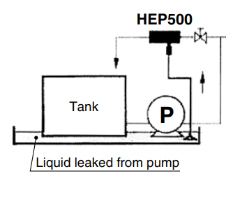

Hello guys, running a small project at a client's site wherein he has a problem of leakage from pumps and the machine's door causing cutting oil to start collecting in a tray kept beneath the machine. They are now using a Vacuum Cleaner to suck up this oil once every 30 minutes or so and this oil is then returned to the tank.
We have given them our Venturi based Liquid Reclaimer which takes coolant from the coolant pump's delivery end and the resulting vacuum induced by the venturi is used to suck up the oil from the tray and this oil is sent back to the tank along with the oil passing through the venturi. Please see the below image from a similar product by SMC.
Now the problem is that the venturi is not able to create enough suction to transfer the oil fast enough, so we decided to connect another venturi in series with the first one. Connecting them in parallel was not an option as the amount of oil passing through both venturis caused a pressure drop alarm inside the machine.
So now when both venturis are connected in series, the oil exiting the first venturi and entering the 2nd one passes through a reduced diameter (at inlet of 2nd venturi) thus throttling the flow and causing a backpressure in the first venturi. This backpressure led to a reverse flow of oil and we had oil coming out of the suction port of the venturi itself! Video -

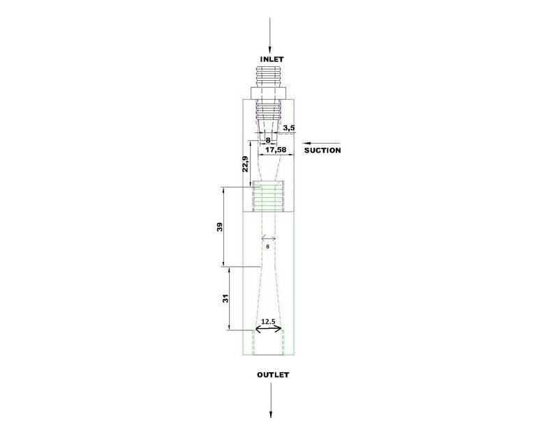

Here is the Eductor we have used. What do I need to change to increase the suction at the Suction Port?
