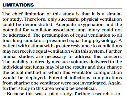

This paper is a preliminary evaluation. It looks like pressure control or volume control. Pressure setting was 25 cm H2O and volume was set to 2L tidal volume (whatever that is) or 500 mL per test lung. Respiratory stacking was monitored but not CO2. Looks like it is just mechanical breathing. Probably the patient would be put completely under. Sounds dangerous.
Here is a discussion of how it will be accomplished. Definitely sub-optimal.
Likes BillTre
Yikes, it looks like they are skipping any animal studies and going straight to humans now. Or we are the animal study, I guess.
And the cross-infection issue seems significant. Sure, all the Patients have COVID-19, but if one has developed pneumonia and the others on the same ventilator haven't yet...
Likes BillTre
I have serious concerns about the ethics of this. Maybe this is effective, maybe it isn't, and maybe as you say, it will make things worse. And even "effective" has a lot of gray to it: do we know the prognosis of a patient who has advanced far enough to require a ventilator? I know "triage" is a dirty word, but before performing medical experiments on our populace, it would be good to have some idea that it would help.

Other than the potential for spreading pathogens among a group of patients in one ventilator, my concern is that pumping air into different patients (linked up in parallel) would have similar issues to current flow through parallel resistors.
The flow would be determined by the relative resistances of the set of patients rather than what each individual patient's diseased physiolgy would be best getting.
This would be especially problematic if it is standard to either individualize the settings of a ventilator for particular patients or if the were feedbacks from patient's physiology controlling the pumping. Which patient's feedback would be used, or would they be combined in some way?
As the paper I quoted stated, this would require all patients be matched so that their physiology was similar. They would likely all be sedated as this type of respiration is supposed to be “uncomfortable.”
