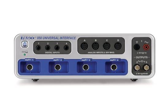

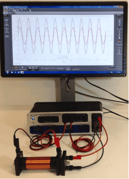

All that was given was this, there is an inner coil and an outer coil. I got the machine picture to make things more clear.
the inner coil goes into the outer coil, in the apparatus you can only see the outer coil because the inner coil is inside
Ah, I understand now. Yeah, if you put 10Vpp into the smaller coil, the step-up-effect will generate a large output voltage. It sounds like you are using the same instrument to drive one coil and observe the other coil, right?
If the same (gauge) wire is used to wind the primary and secondary coils, you can estimate the ratio ##\frac{N_p}{N_s}## from the two resistances, which you are given. Can you say why that is true?

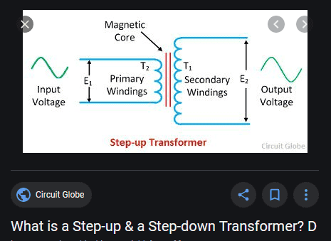

https://circuitglobe.com/step-up-and-step-down-transformers.html
