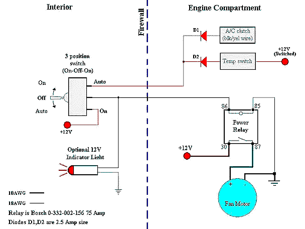

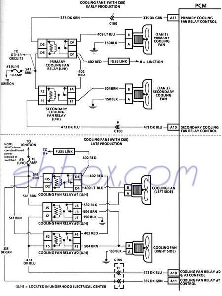

What I'm tring to do is connect FAN 2 Wiring (673 DKBLU 2nd picture top diagram) to
The Auto pole of the AUTO/ON/OFF switch so I can manually activate the FAN if needed.
I'm a little confused since in the 2nd pic, I don't see a Negative side to the coil on the relay.
Can/will this work?
