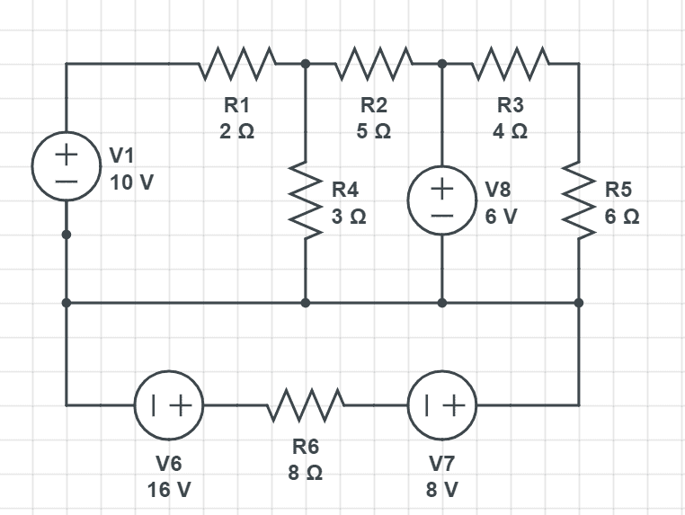

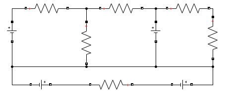

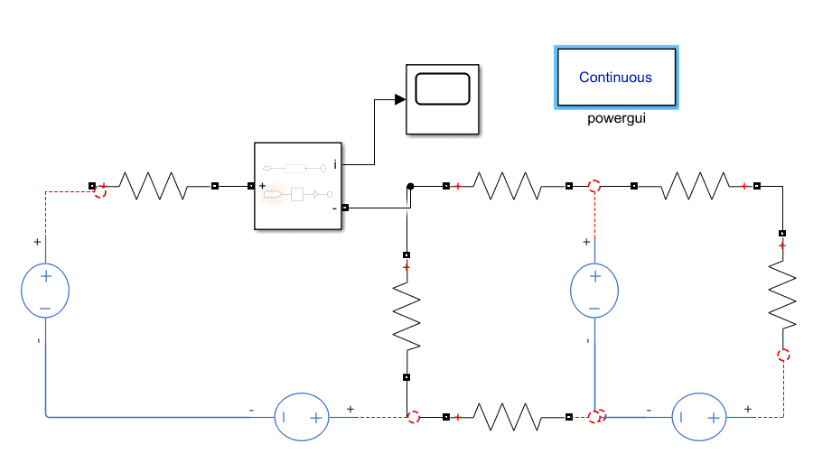

Use MATLAB to find the current flowing through 2Ω resistance
Here's my work :
The DC voltage sources won't connect to the resistances , I get a red dotted line.
Where am I doing wrong ?
Your help is appreciated .
It is quite late, but I will help somehow. You had chosen two different libraries. So if you want to use both, you should find a 'converter', otherwise just keep your project in one library, as I did. It
