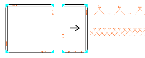

I've tried to draw something although I agree it's not Mona Lisa:
Leftmost is the situation in co-moving frame. Center is the situation in a moving frame. To the right top is the path of one photon, as I imagine it, obviously not to scale. Right center is the combined path of all 4 photons.
While there *might* be a speed where the knots cancel out, it certainly won't work for all speeds.

No, as the path of one photon shows. Are you implying the square will wobble in the moving reference frame?
I'm saying that if the photon does not change direction by exactly 90 degrees, your argument that the force needed to redirect it is purely radial, so no torque is exerted on the square, no longer holds. There will be a tangential component to the force, and that component will exert a torque on the square.

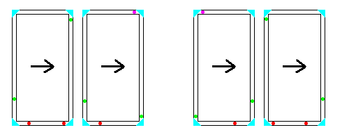

Another good point, but how about this:
Let's replace the photons with another 4 that are running in the other direction. In the stationary frame, the square's wobbling is exactly the same as before, so it must be the same in the moving frame as well.
But now it smoothes peaks in a very different movement pattern (the peaks in the sum of the angular momenta of the 4 photons).
To me it implies that the square's angular momentum equals its negative at all times, meaning it's zero, meaning it can't cancel the peaks.
By "replace" you mean we still have 4 photons, just going around in the opposite direction, correct?

Let me recap how I understand your view:
1) You agree that the sum of angular momenta of the CCW running photons themselves is not constant over time
2) The total angular momentum of the system is constant
3) Thus the square's wobbling must cancel the irregularities in the photon sum (1).
If I make the pattern in (1) negative, and the square's wobbling is the same, it can't add to a constant again.

OK now that I got my own thread o_O I can show a bit of "analysis" I prepared before.
The image shows 2 moments:
1. Before and after 2 photons bounce off the 2 front mirrors,
2. Before and after 2 photons bounce off the 2 rear mirrors.
The positions of photons are guessed but should be approximately correct.
My computation says that the time spent in the top tube is ##T_T=\frac{\gamma}{c}(1-v/c)##.
Time in front and rear tube is ##T_F=T_R=\frac{\gamma}{c}##.
Time in bottom tube is ##T_B=\frac{\gamma}{c}(1+v/c)##.
Then, it seems that the photon's energy has to adjust accordingly, to keep constant number of waevs in each tube. This is shown by the colors of photons in the above image.
At the moment of the front bounce, each of the photons gain the same amount of energy (##\frac{\gamma}{c}(v/c)##), so the center of mass should be at the middle, or it will jump.
On the other hand, if angular momentum was to be conserved, the center of rotation would have to be a bit below the middle. I haven't tried to figure out the exact position, partially because it seems like nonsense.
Another issue: at the time of front bounce (left image), the total energy of the photons increases, while the construction is accelerated overall, so energy is not conserved.
This is compensated during the read bounce.
