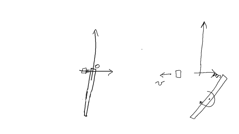

I find conservation of energy and linear momentum to be quite natural to understand, but I find conservation of angular momentum really, really tricky. Let me give two examples:
(a) I call my system as a stick with identical springs at its ends, facing opposite directions, each spring is coiled with an identical marble. The whole system is at rest, and the origin of my system of coordinates is the center of the stick. Therefore at T=0s my total linear momentum and angular momentum are both zero. Then at T=1s the springs release, shooting out the marbles at opposite directions, and the stick starts to spin. The total linear momentum is still 0, but while the total angular momentum around origin of the two marbles is zero (they cancel each other), the stick is spinning and will have a non-zero angular momentum, so the total angular momentum of my system is now non-zero. There were no external forces or torques... I can't understand how there can be any conservation of angular momentum if I applied no external forces or torques to my system, and now the thing is spinning...
(b) I call my system a slightly asymmetrical cloud of gas at rest around its center of gravity, with no rotations. Total angular momentum is zero. Gravity starts to do its thing, and the cloud starts to collapse to its center of gravity, but the thing is slightly asymmetrical, so the collapse is not perfect - it will start to have differences in speed, which, for being a gas, will eventually cause the thing to rotate. At some point the cloud of gas is collapsing and rotating towards its center of mass, until it forms an excellent rotating disk on its way to making a star. The direction of rotation will somehow depend on these initial irregularities, but whatever it is, now the system has a non-zero angular momentum. But there were no external forces, just internal force of gravity.
In both cases total linear momentum was conserved and total energy was conserved, but angular momentum was not conserved even if there were no external forces or torque... what am I missing here?
fbs7 said:
...while the total angular momentum around origin of the two marbles is zero (they cancel each other)...
This is not correct. Both marbles are being fired in the same angular direction, so they have a combined non-zero angular momentum.
I'll let someone else tackle the second.

AAHH! Now I see it! OMG, you folks are so bright! I have been thinking about this for a whole month and in 10 seconds you got the error in the argument! That's awesome! I'm flabbergasted - thanks so much for the explanation!
Now, if I can abuse your kind goodwill, what if it's just one marble, and the origin of my coordinate system is located exactly at the marble, like this:
On that coordinate system the marble is flying away from the origin, so Lmarble = r.m.v = 0 because r = 0, as the marble will have a radial movement. Based on what you said I I'm guessing that maybe there will be two components of the angular momentum of the stick, so the matter would be to prove that the stick will also have Lstick=0, because it has a rotation and also a linear component going on, and I guess their angular moments cancel each other (in this coordinate system, that is)?
That is exactly correct. The center of mass is moving to the right, giving it an angular momentum going out of the page wrt the origin. The stick also has an angular momentum wrt its center of mass that goes into the page. They cancel.

  • #31
Could you clarify this. Aren't the marbles going in opposite directions: i.e. 180 degrees apart? Why are you saying they have the same angular direction?
Are you saying that the momentum of the marbles is not zero because their trajectories draw parallel lines and not a single line (if the trajectory lines are extended in both directions)? Sorry for my thick brain on this one.
  • #32
If the stick is vertical and you fire a marble to the right from the top end and to the left from the bottom end, both are being fired clockwise (albeit on tangents), pushing the stick counterclockwise.
