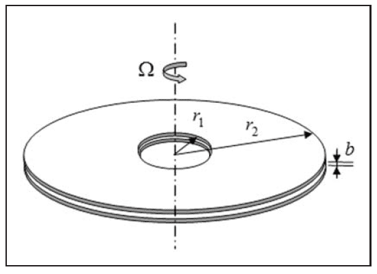

I have a disc that is rotating due to air being blown at its outer radius. The incoming relative velocity of the air is high, therefore the effect of friction supersedes the effect of conservation of angular momentum. The tangential portion of this velocity decreases due to the friction as it travels (swirls) towards the inner radius of the disc. When the tangential velocity reaches its minimum, the tangential velocity then begins to increase due to the conservation of angular momentum.
How does tangential velocity increase due to conservation of angular momentum and not just stay at its minimum value?

I am sorry I should have included this in the main message. When I say disc I am referring to the discs within a tesla turbine. I have attached an image of the discs, the air enters at the outer radius r2 and exits the turbine through the central exit at r1.
The specific paper that I am referencing is "A theory of Tesla disc turbines" by Sayantan Sengupta and Abhijit Guha. My question derives from the statement:
"For a high value of gamma=Vtheta/(angular velocity*r2), the relative tangential velocity is high, therefore the effect of friction may supersede the effect of conservation of angular momentum. This is why, when gamma is high, tangential velocity initially decreases from the inlet (r2) up to a certain value of r/r2 at which it attains its minimum value. At lower values of r/r2, it increases again as the effect of the angular momentum conservation starts to dominate."

This concept is basically flawed. If it appears to you that angular momentum is not conserved then you need to approach the problem differently. The disc is not isolated and neither is the gas around it so you can't look for or apply conservation. There will be a velocity profile of gas with distance from the disc surface, Whenever there is a difference in velocity between the disc surface and the gas flow, momentum will be transferred.

As I read it, that passage discusses whether friction or momentum is dominant in different regions. It does not imply that momentum is not conserved. A passage like that is difficult to interpret in any language. It should be accompanied by equations and curves to make the point.

Any vortices formed in between the discs will involve angular momentum and that can transfer to the discs by friction. So I think your question could be modified to ask when the transfer is greater or less by straight tangential force from free flowing gas or by a tangential couples from the gas vortices. Presumably the vortices will increase as the angular velocity of the discs increases.

If air is being blown at the outer radius, there is an external torque acting on the disk. If an external torque is acting on the disk, its angular momentum is not conserved.

If I were to blow a finite amount of air into the turbine and no more, and then say that my control volume contains the discs and the finite amount of air, could I apply the conservation of momentum to that cv?
I believe that in this cv, the air transfers its momentum to the discs via shear force, which retards the air flow until it reaches a minimum point. At the minimum point there is no more momentum transfer since there is no longer a gradient between the flow and the disc. From this point on there are no momentum transfers.

What if we disregard the solid walls and the flow on the outside of the two discs and are just looking at the flow in between the rotating discs, nowhere else. In this case the concept of conservation could be applied to the discs and fluid, correct?
Now the model is simplified to exclude any friction via bearings, container walls, and more and only include flow through a microchannel that is rotating and the discs. I believe in this case conservation of momentum is applicable to the system albeit a rather simplified model but atleast a starting point.
It's reasonable to say that some or most of the net momentum of the incoming gas will be transferred to the disc but I would say that the turbulence which provides coupling of that aspect of the angular momentum between gas and disc is bound to be lossy and that some angular momentum has to be lost. The other coupling, between the linear momentum of the gas and angular momentum of the disc is also relevant. I think your original question is basically about the relative amounts of each. But each involves friction - there is no other mechanism to make the disc spin and that's why I questioned your original dichotomy. You are right to try to apply the momentum conservation principle, as with any collision problem. You need to include the momentum of the exit gas too, because the mass flow rate in and out must be the same - apart from any slight effect of pressure change with speed.

This post puzzles me.
First, it is not true that the momentum of the incoming gas will be transferred to the disk. Note the conditions specified in #19. No torque at the bearings. No drag from the walls. That means that in steady state, zero net angular momentum is transferred to the system from the mass flow. This presumably means that the turbine is spinning fast enough that any angular momentum carried in by the input stream is carried out by a very rapidly spinning vortex in the output stream.
Next, there is no loss of angular momentum due to any sort of coupling. Angular momentum is a conserved quantity. It cannot be lost. You can lose rotational kinetic energy. But you cannot lose angular momentum.
Next, the mass flow rate in must match the mass flow rate out. Full stop. Pressure changes do not enter in. Those would affect the volumetric flow rate.
Finally, the most relevant factor for pressure change is likely not Bernoulli but rather centripetal acceleration. You have high pressure for the high velocity gas at the rim and low pressure for the low velocity gas in the middle -- the opposite of Bernoulli.

Yes, it's a bit muddled -sorry.
1. I meant that any effect must be due to friction.
2. There is a linear force produced by the straight passage of gas. This provides a couple, directly.
3. Once the gas gets turbulent (due to interaction with the moving discs) the gas has a different distribution of angular momentum and that couples - again by friction - with the discs.
I imagine that, as the side speeds up, the transfer by a direct couple will be less because the speeds of the outer bits of the discs will be similar to the gas speed.
The only links I could find are quite complicated but it seems that the reduced pressure in the gap produces the vortices. The matter of the Momentum is difficult and you must be right that a constant disc speed implies no momentum transfer. But the behaviour of an engine with no load is not straightforward - same for an electric motor which has an infinite speed limit in the absence of resistive losses because the back emf is never quite the same as the supply volts. Presumably there is an equivalent to back emf and losses in this turbine which will limit the top speed. How useful or practical is it, to do the no-load analysis? As soon as the turbine does work, conservation doesn't apply because it is outputting Impulse on its shaft. I wonder if the extra condition in #19 doesn't take things out of the realms of usefulness. Turbines are all about momentum transfer to a load. ( Post #19 was added a bit late in the day, perhaps.)
Yes, Mass flow rate will be constant if the turbine is enclosed. I'm not sure that the Bernouli effect doesn't cause the vortices.
