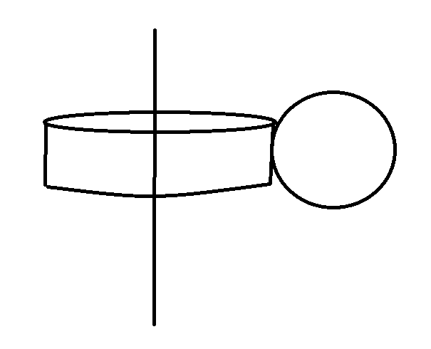

A disc is spinning at 6.8 rad/s about the centre of the disc. A solid iron sphere is then attached to the edge of the disc and rotate together, find the angular velocity of the whole system now.
Not sure what to do here, except using the conversation of angular momentum. Even then, is angular momentum conserved in this case even after attaching an external object here? Else, what laws can I use to solve this problem?
Using conversation of angular momentum:
$$\dfrac {1}{2}M_{disc}R^{2}_{disc}\left( 6.8\right) =\left( M_{disc}R^{2}_{disc}W\right) +\left( \dfrac {2}{5}M_{sphere}\left( R_{disc}+R_{sphere}\right) ^{2}W\right) $$
Is this correct?

Judging by the 6.8 in your proposed solution, it seems that there was more information present in the original problem statement than you have provided here.
No. Your solution is not correct. The parallel axis theorem should figure prominently in your calculations.
We need to understand the situation better. Is the iron sphere supposed to be moving already on a perfectly tangent trajectory when it brushes up against the rim of the disc and is instantly welded into place? Or is it at rest when it is instantly welded into place and thereby jerked into motion?
Is the disc fixed to an axle at its center? Or is it spinning freely in space? If the latter is the case, where is the new axis of rotation of the unbalanced disc after the sphere has been attached?
Likes jisbon

The question simply states:
A iron sphere is attracted to the edge of the disc and they rotate together. I will assume it is at rest when it is instantly welded into place and thereby jerked into motion.
I will assume the disc fixed to an axle at its center, so r shouldn't change?
EDIT: Got the answer. In this case, disc is fixed an ball is instantly attracted.

But do you now see what was wrong with your application of the parallel axis theorem?
My guess:
## L_i = L_f ##
## [Iω]_i = [Iω]_f ##
## [\frac{1}{2}M_{disk} R^{2}_{disk}] [6.8 \frac{rad}{s}] = {[\frac{1}{2}M_{disk} R^{2}_{disk} + M_{sphere} ({R_{disk}+R_{sphere}})^{2}][ω_f]}##
Now, solve for ##ω_f##.

That appears to be correct for a point mass ##M_{sphere}## in magnitude attached to a point ##R_{sphere}## further out than the physical rim of the disk. It does not account for the moment of inertia of the sphere about its own axis.

If the sphere is insta-welded onto the disk, it will most certainly begin rotating about its own axis at the same rate that the disk is rotating about its axis. That is to say, it will rotate along with the disk rather than presenting a fixed face to the distant stars.

Yes. And if they rotate together, they both rotate.

Post #3 seems to indicate that the disc is anchored with an axle at its center, yes.

The sphere is moving in a circle around the center of the disk. And it is rotating as it moves so that the point of attachment stays firmly attached to the disk.
If you want to call that "rotating strictly", that is fine. But both the motion in a circle and the rotation add to the angular momentum of the sphere.
