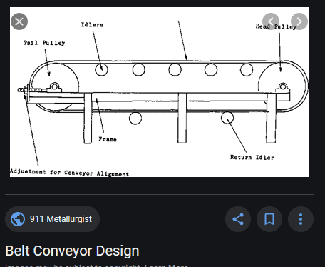

Maybe the whole Earth / car system is adding too much confusion for you. Instead, think of a simplified system with a car held down on a conveyor belt in space away from the Earth. That's obviously an isolated system, so the linear and angular momentum have to be conserved.
If the car is rear-wheel drive (assuming it's an electric car and can run in the vacuum of space), as the rear wheels start to drive the mass of the conveyor belt, that also spins up the front wheels. The energy for the moving conveyor belt and the front wheels comes from the motor driving the rear wheels. It doesn't come from anywhere else. Does that help?

I guess maybe that helps. But as I said above with my bullet and door example, you can see where Ang momentum goes. As the tires roll on the treadmill, and gains AM, where is it being lost?
Nowhere. The energy to spin up those front wheels comes from the engine driving the rear wheels, which drives the belt and the front wheels. The sum of the AM of the rear wheels, the belt and the back wheels is zero because it's an isolated system.
In this very isolated system, just because the total AM is zero, that doesn't mean that the total rotation of the car+belt system is zero. The driven wheels and the front wheels spin one way, so the whole belt+car system spins the other way to conserve the AM.
