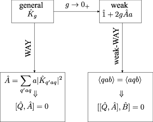

FIG. 2.​
The difference between the WAY and the weak-WAY theorem. The former applies to general measurement and shows that the lack of coherence between eigenstates of ˆQ in the Kraus operators (1) leads to superconservation of the measured quantity. The latter applies to weak measurements (2), leading to a weaker condition for the observed conservation.

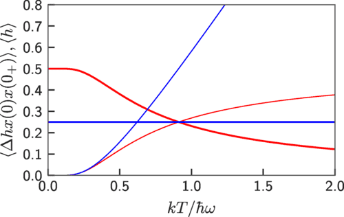

For increasing temperature, the jump diminishes as illustrated in Fig. 3.
FIG. 3.​
The nonconserving jump for τ=0+ (thick lines) compared to the average energy (thin lines) for the two-level system with level spacing ℏω (red) and the harmonic oscillator with eigenfrequency ω (blue). At high temperatures, the jump becomes unobservable and the classical conservation is restored. All quantities are normalized to ℏω.
Another basic example is the harmonic oscillator with ˆH=ˆQ=ℏωˆa†ˆa with [ˆa,ˆa†]=1. Taking the dimensionless position √2ˆX=ˆa†+ˆa=ˆA=ˆB, we find for the jump ⟨Δhx(0)x(t)⟩=−ℏωcos(ωt)/4, independent of the state of the system (see Appendix A). As illustrated in Fig. 3, the jump becomes unobservable at high temperatures since the average energy ⟨h⟩=ℏω/[exp(ℏω/kT)−1] increases with temperature.

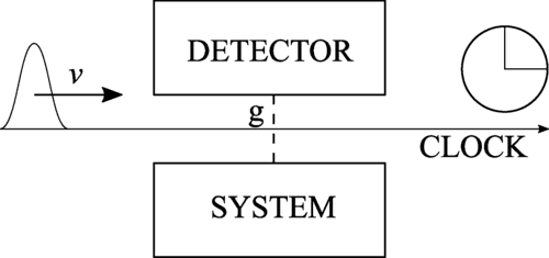

The previously discussed very simple examples illustrate the fundamental finding of our paper. If one tries to verify the conservation of energy while measuring another observable that is not commuting with the Hamiltonian, it is possible to find a violation of the energy conservation. It constitutes a pure quantum effect since it vanishes at high temperature, where the classically expected conservation holds. One could object that performing a series of measurements already breaks time-translational symmetry and, therefore, the total energy is not conserved. However, one can keep the time symmetry by replacing the detector-system interaction by a clock-based detection scheme [9] (see Fig. 4). The total Hamiltonian reads
ˆH+ˆHx+ˆHz+ˆHI,
(12)​
where ˆH is the system's part, ˆHx is the detector's part, ˆHz is the clock's part, and ˆHI is the interaction between the clock, the system, and detector. Each part is time-independent so the time-translation symmetry is preserved. Both the detector and the clock can be represented by single real variables, x and z. Now, to measure the system's ˆA at time t1, we set ˆHx=0 and
ˆHz=vˆpz,ˆHI=gˆAδ(ˆz)ˆpx,
(13)​
where ˆpx,z are conjugate (momenta), i.e., ˆpx=−iℏ∂/∂x and g→0 is a weak coupling constant. The initial state (at t=0) reads ˆρˆρxˆρz, where both ˆρx,z=|ψx,z⟩⟨ψx,z∣∣ are taken as Gaussian states
ψz(z)=(2πσ)−1/4exp(−(z+vt1)2/4σ),ψx(x)=(π/2)−1/4exp(−x2),
(14)​
respectively. For small g and σ, the interaction effectively occurs at time t=t1 and, in the end (after the clock decouples the system and the detector again) to lowest order we find (see details in Appendix B)
⟨x⟩≃g⟨ˆA⟩=g⟨a(t1)⟩.
(15)​
For sequential measurements, one simply adds more independent detectors and clocks, obtaining in the lowest order of g
⟨xAxB⟩≃g2⟨a(t1)b(t2)⟩,⟨xAxBxC⟩≃g3⟨a(t1)b(t2)c(t3)⟩,⟨xAxBxCxD⟩≃g4⟨a(t1)b(t2)c(t3)d(t4)⟩,
(16)​
with the right-hand sides are given by the quantum expressions (7).
FIG. 4.​
Detection model based on a clock. The clock is a localized particle traveling with a constant speed v. The interaction between the detector and system takes place only when the clock is passing the interaction point.
Although the above detection model is based on time-invariant dynamics, the initial state of the clock spoils the symmetry. The time-invariant state would require a constant flow of particles or field at a constant velocity, so that the position on the tape imprints time of measurement (see [31] for detailed construction). However, such a constant interaction between the detector (clock) and the system leads to a backaction and makes the measurement invasiveness growing with time, which needs to be reduced by additional resources, e.g., additional coupling to a heat bath.
