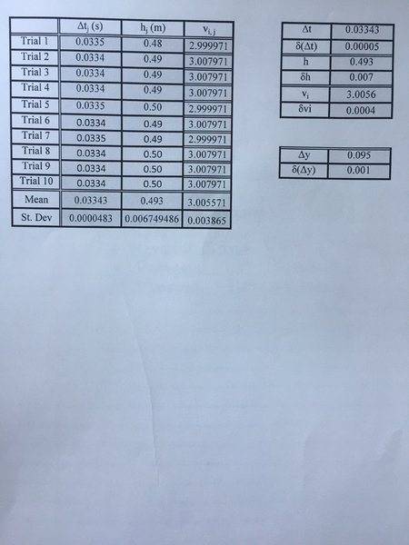

If you think looking at my experimental data will help, I have included it as an attachment.
The set up:
A launcher pointing upwards with two photogates measuring time it took for the projectile to pass from the bottom one to the top one. The photogates were approximately 10 cm apart from each other (however I measured them to be 9.5cm). By using this set up I was able to determine initial velocity of each trial. A meter stick was fastened up vertically to measure height of the ball. The 0 of the meter stick was lined up with the bottom photogate. Values for h (y final) were measured by sight only. ( I realize there is room for discrepancy here).
mass of the projectile is not included on my data sheet. It is 0.016116 kg
Issues with data:
I reported height (h) to nearest cm. (values are reported in meters), while it may have been in my favor to attempt to calculate to the mm. By eyesight, this is rather difficult. But the experiment didn't specify this.
Also... the distance from the top and bottom photogate was different from one side to another. I should have measured the other side that was braced to a bar, which would have likely given me a measurement closer to the 10 cm I was looking for. Thanks again for your help!

Your data look pretty close.
[tex]\frac{1}{2}mv^2 = mgh[/tex]
[tex](3m/s)^2 = 2 * 9.8\frac{m}{s^2} 0.5m[/tex]
[tex]9\frac{m^2}{s^2} = 9.8 \frac{m^2}{s^2}[/tex]
Certainly determining the launch velocity with sensors that far apart is problematic. Which direction would that give you an error in your data? Is it in the right direction to help to explain the difference in the two numbers in my last equation?
Or did you already apply the correction needed to account for the separation of the 2 gates? If not, can you say how you could calculate how to correct that time to give you the real initial velocity at the first photogate? :smile:
