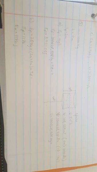

A cylindrical container of water has a diameter of 7.98 m and a perpendicular height of 2 m. It is filled with water (1000 kg = 1000 l) and placed on top of a 4 m stand. Calculate the:
A) potential energy of the water
B) kinetic energy of 20 kg of water just before it reaches the ground, if the container over flows.
C) velocity when the 20kg reaches the ground.
D) potential energy of the top half of the water.
E) potential energy of the bottom half of the water.
Answers:
A) 4.901 MJ
B) 1176 J ------->I was able to solve this one
C) 10.844 m/s ---->I was able to solve this one aswell
D) 2.696 MJ
E) 2.696 MJ
Thank you :oldsmile:

It is hard to read your work, can you type it out?
Your potential energy seems way off. It looks like you inserted a very large number in for the mass and I'm not sure where that came from. Also, you used 4m as the height of the water. The problem is that much of the water is higher than 4m above the ground. The correct distance will be the average high of the water.
I think part B is ok.
I don't see your work for the following parts.

@NFuller claims PE 4.9 MJ is way off; I 'think' it's still low :smile: [edit] correct but with too many decimals.
[edit] from you r D and E I'd say they are at the same height. Strange :rolleyes:
As others have remarked, the image is too faint, and it is unclear whether the answers listed are your own or from the book.
For A, I agree with the 4.9MJ answer posted, but in the image you seem to have a lower number as a result of using the wrong average height. The working seems to include a mass value something like 100028, but perhaps I am misreading it.
The D answer posted is consistent with the A answer, but E is not. Maybe you looked at the wrong number when typing the post?
