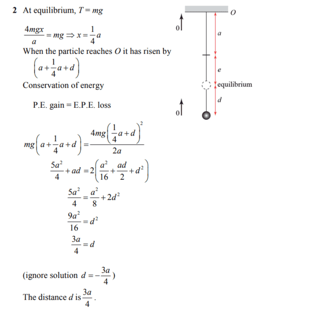

A particle of mass m is suspended from a fixed point O by a light spring of natural length a and modulus of elasticity 4mg, the particle is pulled vertically down a distance d from its equilibrium position and released, find d if the particle just reaches O.
T = modulus of elasticity (extension) / natural length
EPE = modulus of elasticity (extension)^2 / 2 x natural length
Start by finding the equilibrium position, so we have {4mgx}/{a} = mg giving us x = a/4, therefore the spring's length is 5a/4. Now the loss in EPE (and therefore gain in energy of the particle) between the bottom and the equilibrium position is clearly 4mg((a/4 + d)^2 , and then from the equilibrium position up to O, the particle loses 4mg(a^2)/2a (as this is the gain in EPE), therefore in total the particle's energy has changed by 4mg((a/4 + d)^2 - 4mg(a^2)/2a, and this should equal the change in GPE (- the work done by gravity), which is clearly mg(5a/4 + d), this gives us d=5/4(a), whereas my textbook does something else, could someone let me know if either mine or the textbook's working is wrong? Thanks
The textbook answer is correct. Although, this is for an elastic string, which requires no force/energy to compress.
The total EPE stored in the string is ##\frac{4mg}{2a}(x - a)^2##, where ##x## is the total extension. In this case ##x = a + \frac a 4 + d##.
Alternatively, the total EPE in the string is ##\frac{4mg}{2a}(\Delta x)^2##, where ##\Delta x## is the extension beyond the natural length. In this case ##\Delta x = \frac a 4 + d##.

The textbook solution is for a string, not a spring. A spring makes little physical sense in this case - although that would be nothing new!
But, you still have a mistake in using the intermediate equilibrium point. I don't understand why you subtracted that term.
As the particle moves a distance of d + a/4 up, it gains energy, we know it gains an equal amount to the EPE of the string. Then as the particle moves a distance of a up, it loses energy (As it costs energy to squish the spring down to a length of 0, from its natural length). Is my misunderstanding that the spring does not need any force to compress? I have edited my post aswell, check if that makes more sense now.

The textbook solution is for a sTring (with a T) not a sPring (with a P). A sTring requires no energy to compress from its natural length.

I think I understand your approach. There is EPE stored in the initial extension from ##a## to ##\frac{5a}{4}## to reach the equilibrium position. The question is whether the mass is pulled far enough to utilise that energy. If you don't pull the mass at all, then that energy cannot be released. There is an assumption that the mass is pulled far enough to be accelerated up beyond the natural length and hence release all the EPE.
In this case, as ##d = \frac{3a}{4}##, that is much greater than ##\frac a 4##, so the string will definitely release all its EPE as the mass will go up and beyond the natural length.
I am happy with all the EPE being released, the issue was that I thought the particle needed some energy to squish the string down from a length of a to 0, but apparently you don't need any extra energy for that.
