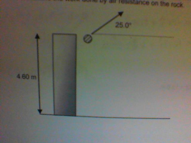

A 250 gram rock is thrown with a speed of 30.0 m/s. It has a speed of 22.5 m/s just before it strikes the ground. Determine the work done by air resistance.
There is also a diagram which yields more information. The rocks path is horizontal and it strikes the corner of a box that is 4.60 meters tall, ricocheting the rock at a 25 degree angle. (That is, the ball is projected at a 25 degree angle from a height of 4.6 meters).
Ei+Pi=Kf+Pf+(work done by air resistance)
Kf=63.3J, Ki=113J Pf=0, Pi=?
I am having difficulty with the idea of the horizontal path the rock travels and the gravitational potential energy... As well as what exactly to do with the the angle of projection. I understand that I need the initial and final conditions only... but this one is really stumping me. I thank you all in advance for your considerations and help.

Ah I am sorry. So as the diagram appears, The rock is thrown 4.6 meters above the ground and is traveling horizontally. It then collides with the corner of the box and ricochets off at a 25 degree angle, taking a parabolic path to the ground.
I am not sure about the collision. There is a decrease in its velocity from when it is thrown to just before it strikes the ground, so I imagine it is not perfectly elastic. But that is all the information given.
Here is the diagram. I am a newb and did not realize I could do this or I would have on my original post.
I guess you have to neglect the fact that nothing can be thrown that travels perfectly horizontally or just neglect this portion of the work done by air friction.

If you were to ask me, it looks like that horizontal line is just a reference to show that the 25.0 deg angle is with respect to the horizontal. In other words, the horizontal line is not part of the rock's path; it's just there for reference. I don't think there is a collision at all. To me it looks like the rock is initially launched, with its full initial speed, from a height of 4.60 meters.
So now apply your conservation of energy equation that you listed in the initial post. You've already calculated the kinetic energies (you might want to be more careful about your precision/rounding, btw.) You should have enough information now to calculate the potential energies.
AH HAH! Man... Now I feel like a complete dumb dumb. THANK YOU so much... I believe you are correct. I shall work it out now.
I swear... physics is the easiest thing to over complicate.
