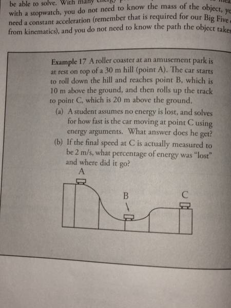

A roller coaster at an amusement park is at rest on top of a 30 m hill (point A). The car starts to roll down the hill and reaches point B which is 10 m above the ground, and then rolls up the track to point C, which is 20 m above the ground.
(A) A student assumes no energy is lost, and solves for how fast the car is moving at point C using energy arguments. What answer does he get?
(B) If the final speed at C is actually measured to be 2 m/s, what percentage of energy was "lost" and where did it go?
