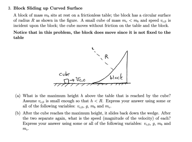

Hi, I'm working on part a of the following mechanics problem from MIT Open Courseware: https://ocw.mit.edu/courses/8-01sc-classical-mechanics-fall-2016/resources/mit8_01f16_pset9/:
I think the key to solving this problem relies on the conservation of mechanical energy. Since there are no nonconservative forces acting on this system, total mechanical energy is conserved.
However, it's not immediately apparent to me what I should consider the system as. I can treat the cube as my system, or the block and the cube together as my system. Both seem equally valid to me. All the forces acting on the cube are conservative (the normal force on the block is perpendicular to the direction it's travelling in, so we need not consider it). Similarly, all the forces acting on the block are conservative. So conservation of mechanical energy should hold for both.
Before we proceed, let us denote the final velocities of the cube and the block as ##v_\rm{final} ##.
If we consider only the cube as our system when using conservation of mechanical energy, we get the following equations:
By conservation of mechanical energy:
##\frac 1 2 m_\rm{c} (v_\rm{c,0})^2 = mgh + \frac 1 2 m_\rm{c} (v_\rm{final})^2##
Assuming the time it takes for the cube to climb up the block is small, we can equate the momentum at the initial and final times:
##m_\rm{c} v_\rm{c,0} = (m_\rm{c} + m_\rm{b}) v_\rm{final}##
However, if we consider the cube and the block as our system when using conservation of mechanical energy, we get the following equations:
##\frac 1 2 m_\rm{c} (v_\rm{c,0})^2 = mgh + \frac 1 2 m_\rm{c} (v_\rm{final})^2 + \frac 1 2 m_\rm{b} (v_\rm{final})^2##
These are two sets of equations - they would give us different results. So how do I determine which set is valid?

Think about this last claim for a moment.
1. If you are taking the cube as your system then the normal force of cube on block is irrelevant. You need to be considering the normal force of block on cube.
2. Is the normal force of block on cube really perpendicular to the direction the cube is travelling?

Correct me if I'm wrong, but isn't the normal force of the block on the cube perpendicular to the direction the cube is travelling? The block is circular, so the cube is travelling tangent to the surface of the block. Meanwhile, the normal force of the block on the cube acts in the radial direction, so the normal force is perpendicular to the direction the block is moving.
No. It is not.
It would be perpendicular if the block were not moving.

The work done by the normal force of cube on block will be equal and opposite to the work done by the normal force of block on cube. Neither will be zero.
It is most convenient to define the system boundaries so that this force pair is internal and may be ignored. In the absence of friction, internal contact force pairs do not drain mechanical energy.

Could you elaborate a bit more on this part? I thought when an object moves in a circle, the direction of motion is always tangent to the circle - and we are given that the ramp is circular.
Why would the block being in motion change that?
I see - so we consider the block and the cube as one system, so that the work done by their internal forces cancel out - is that right?
If you superimpose a linear motion on a circular motion, you get a cycloid. Like the path drawn out by a point on a tire.
If you superimpose a non-uniform linear motion on a non-uniform circular motion as in the case at hand, the resulting motion will be more difficult to characterize. Fortunately, we can invoke conservation laws and ignore the path from initial to final state. As long as the forces along the path are energy-conserving, all is well.

To answer your original question, you can be sure that the choice of cube + block system equations are valid because (a) the system's mechanical energy is conserved (no friction anywhere) and (b) the system's momentum in the horizontal direction is conserved (no horizontal external forces). The two equations that follow from these two considerations, if written correctly, must be valid.
