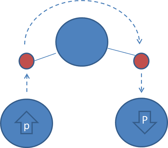

The only way I can see this occurs is the use of Degrees of freedom to momentarily change linear to rotational momentum. then back again in the direction of the flow.
The best analogy I can think of is a tennis ball on string (representing a molecular degree of freedom) is hit against in one direction it rotates around center mass and it hits another ball on the opposite side and imparts momentum in the reverse direction
If we were to equate that to molecules (P representing momentum)
Of course I acknowledge that the exact opposite is equally likely to occur so overall Momentum is Conserved but if you could examine on an individual event basis can rotational momentum be used to reverse a linear momentum vector without a resultant force.
What am I not considering. Does the center mass go backwards ?

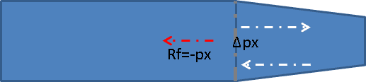

Quentin_C said:
While the pressure gradient must resolve itself in the direction of the flow this requires a change of momentum vector within the flow without a resultant force.
If you have a pressure gradient then you automatically have a resultant force.
Thanks Dale could you expand a bit on how a fluid can provide a resultant force can be with respect to Momentum conservation.
If we treated the fluid as a system then the Momentum (and its vectors) is conserved within that system , there is no way to change the vectors from their original values - without an external force (provided by the walls of the container/pipe)
Yet we see exactly this in the reordering of momentum in a Bernoulli's pressure difference
If we have some random motion- Static Pressure, including some going momentum backwards against the flow (-px) that becomes ordered along the flow in a constriction (+px) , then this backwards momentum -px must experience a resultant force. If this this resultant force is within the fluid, then it must equate to the original -px. The negative momentum has just traveled further upstream, it doesn't change the overall -px momentum within the system, just the position of the it .
∑Δpx=0

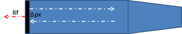

In a straight pipe I could envisage this negative momentum will continue to travel upstream in the liquid against the flow until it reaches a solid surface or whatever is providing the pressure difference (represented by my black piston) at this point it can be reflected by the external force and resolve itself/ and the pressure difference in the direction of the flow.
In this situation I can see that ∑Δpx≠0
What am I getting wrong ?

If you have a pressure gradient, say high pressure on the left and low pressure on the right, then if you consider a small section of fluid there will a large force to the right on the left face and a small force to the left on the right face. So there will be a net force to the right and, in the absence of any other forces in that direction, that small section of fluid will accelerate to the right, gaining momentum to the right.
You seem to be concerned about the conservation of momentum, but momentum is only conserved in an isolated system, and the small section of fluid is not isolated. Neither is the fluid as a whole.

If the system is the whole fluid then the forces causing the acceleration are from outside the system, I.e. the walls of the pipe.
The internal forces due to the pressure gradient are internal forces and cannot cause acceleration of the center of mass.

It comes from all of the stresses on all of the surfaces interacting with the system. You cannot neglect any of them a priori.
