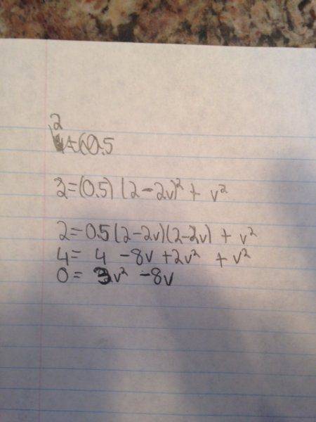

In summary: Wrong answer, please help.Every time I try to substitute the formulas of v1' = 2 - (2)v2 into 2 = 0.5v1'^2 + v2' I get what is shown on the image which doesn't give the right answer when solved through the quadratic formula. Where am I going wrong?

First I put in the values and narrowed the conservation of momentum equation to:
2 = v1' + (2) * v2' which rearranges to v1' = 2 - (2)v2' (equation 1.1)
For the Conservation of Energy equation I did the same and got,
2 = (0.5) v1'^2 + v2'^2 (equation 1.2)
I then substituted the value of v1' from equation 1.1 into 1.2 and simplified to,
v2' (3v2' -4) = 0
v2' = 0 or 1.33
since it is not 0 it must be 1.33 m/s
I then substitute this answer back into equation 1.1 and get
v1' = -0.667
Therefore, the velocity of m1 after the collision is 0.67 m/s to the left and the velocity of m2 = 1.3 m/s to the right.

Every time I try to substitute the formulas of v1' = 2 - (2)v2 into 2 = 0.5v1'^2 + v2' I get what is shown on the image which doesn't give the right answer when solved through the quadratic formula, Where am i going wrong?
Your equation 2 = 0.5(2-2v)(2-2v) + v2 is correct.
However, you make one or more mistakes in going to the next equation 4 = 4 - 8v + 2v2 + v2.
Can you spot your error(s)?
Likes Brendan Webb
yes I can, and did. not only was I forgetting to make it 4v^2, I was forgetting to divide the v^2 by 0.5 to give me 2v^2 for a grand total of 6v^2 and -8v giving me the exact same proportions and answer on the quadratic equation shown by v2' (3v2' -4). Wow i wasted 2 hours stuck in a mind trap.
Thank you
You could have also saved yourself the need to use the quadratic equation.
If you have 6v^2-8v = 0 you can then just factor out v and have v(6v-8) = 0
Looking at this equation you can make the relation true if v = 0 because then 0 times what's in the brackets will be zero. then you can also find the value of v that would make the terms in the brackets equal to zero. saves time from using the quadratic equation.
