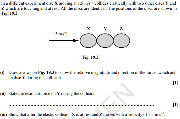

Part (iii) is the part I am stuck on and is a 5 mark question. I have some idea of how to attempt it shown below
momentum is conserved so mux = mvy + mvz
(where ux is the initial velocity before the collision of ball x, vy is the velocity after the collision of ball y and vz is the velocity after the collision of ball z)
They are all indentical masses so they all cancel to give ux = vy + vz
Since kinetic energy is conserved then we have:
½(mux)2 = ½(mvy)2 + ½(mvz)2
The halves and masses cancel to give:
ux2 = vy2 + vz2
Since ux = vy + vz from earlier we have:
(vy + vz)2 = vy2 + vz2 which gives:
vy2 + vz2 + 2vyvz = vy2 + vz2
2vyvz = 0
Now I am stuck as I was going to say that vy must be zero because vz isn't (it is 1.5 m/s). Then I realized the question asks to prove vz is not zero so I can't really use this assumption?
edit: I was going to go on to say that since ball y must be zero then we can go back to the original equation which is ux = vy + vz to say that ux = vz and the question tells us that ux is 1.5 m/s. However, I have had to assume vy is zero but it doesn't give me this information in the question so I can't really do that can I?
Any help is appreciated

You know that vy and vz cannot both be zero.
What is happening if vz is zero?
Likes Jimmy87
If vz is zero then vy has to be moving which isn't possible if they are next to each other. The question stills says to show that ball x is stationary after the collision and I don't get how to show that mathematically either.

Ok hang on I have over complicated this. Forget my vy term and replace it with vx (velocity of ball x after the collision). I can do this since the question before shows that vy has no resultant force and hence must be at rest anyway. This gives me:
2vxvz = 0
So can I now say vx is zero so vz has to be 1.5 m/s. I am still uncomfortable with this as I know vx is zero but I am not actually still proving it am I?
edit: or can I just say vx must be zero since the last question shows ball y is stationary so it is impossible for vx to carry the 1.5m/s and have y stationary? Although this is a qualitative answer rather than a quantitative one.

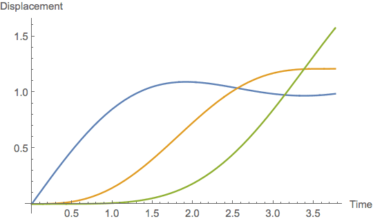

I modeled the three ball case and obtained these displacement curves
244041
Where the red and blue lines cross, the first and second ball lose contact; similarly the second and third lose contact where the red and yellow lines cross.
Finding those points analytically involves solving equations like ##\sin(\sqrt 3\theta)=\sqrt 3\sin(\theta)##.
This model omits that it takes time for the compression wave to transit a ball. So in practice the behaviour may be closer to a "perfect" Newton's Cradle, i.e. as though no simultaneous contact occurs.
However, that does not excuse the question setter in this thread. The analysis required is surely beyond a reasonable level for the student. (Well, it's beyond me anyway.)

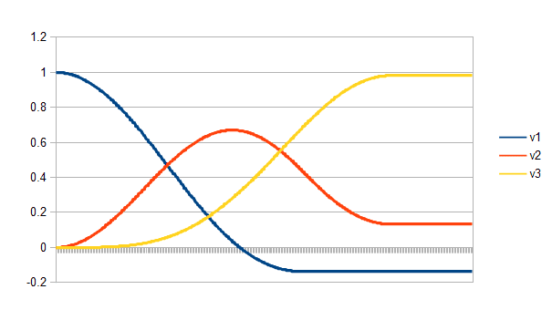

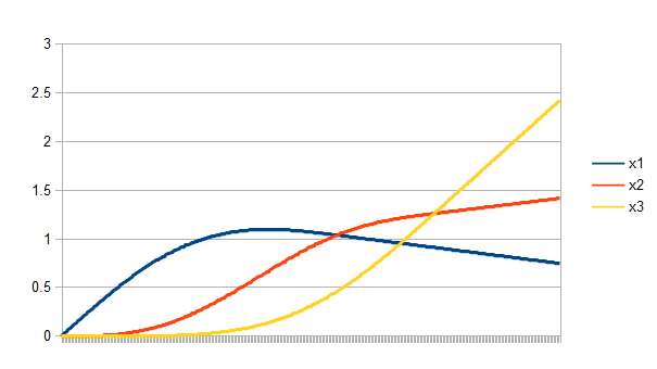

I got very similar plots for the displacements (see below) in the lab frame. I have also appended a graph of the velocities. Why is x1 = x2 the criterion for separation and not v2 - v1 > 0? The two do not occur at the same time.
If x1>x2 then 1 and 2 are in a state of mutual compression.
Except that you have modeled them as stuck together, going into tension rather than separating.

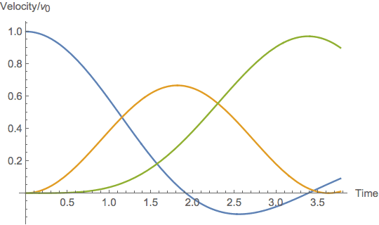

neilparker62 said:
Could you perhaps show a graph of corresponding velocity curves ?
244081
Visually, it looks like rounding errors have led to a net gain in KE, but I checked for that and it is negligible. Just goes to show the quadratic dependence.
Likes neilparker62
Perhaps I do not understand what x1 and x2 stand for. I thought they were the displacements of the center of each mass. In my model the masses can be considered as point masses for the purposes of writing down the equations, however the condition for separation would be ##x_2 - x_1 \geq D## where ##D## is the diameter of the disks.
That is true and I apologize for not making it clear that I did not modify the model to take into account the first and second separations. That's because I wanted to be sure I understood the meaning of separation before I proceeded.
