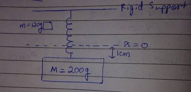

A block of mass 200g is suspended through a vertical spring. The spring is stretched by 1.0 cm when the block is in equilibrium. A particle of mass 120g is dropped on the block from a height of 45 cm. The particle sticks to the block after the impact. Find the maximum extension of the spring. Take g=10 m/s^2.

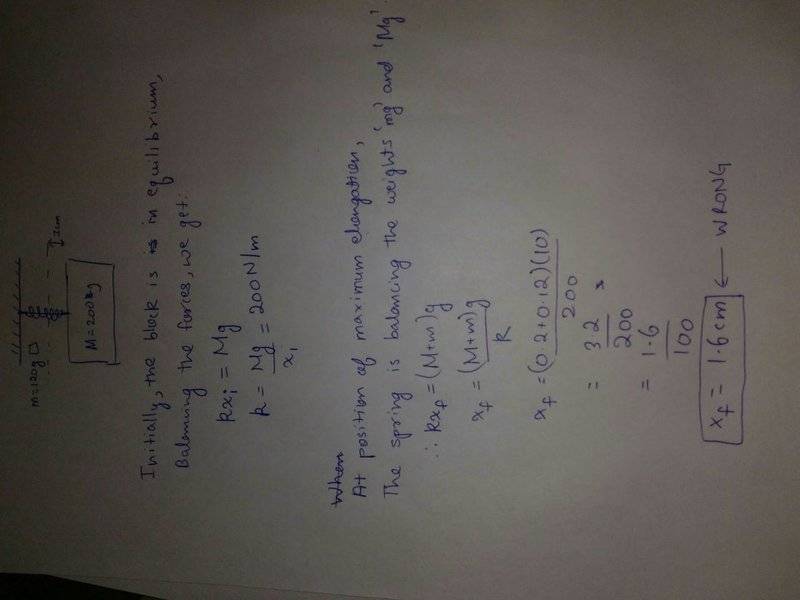

The answer I get is 1.6 cm which is wrong (the correct answer is 6.1 cm). When I looked at the solution, I saw that conservation of momentum was applied first and then conservation of energy. But, I don't see why the momentum can be conserved. There is a net external force on the system because of gravity.
Could someone explain to me what is wrong with my approach and also why momentum conservation can be applied in this case?
Here is a diagram of this problem I drew
You have an inelastic collision when the particle strikes the block so conservation of energy does not apply. Momentum is conserved during the collision, however.
If you drop a weight from some height onto a spring, do you think it will directly go to the equilibrium position?
No. Not directly but only after the kinetic energy of the system becomes zero.

Also, could anyone please explain what was wrong with my approach?

danielbaker453 said:
Also, at the point of maximum elongation,
kxf=(M+m)g
That's the equilibrium position.
Show your work in detail.
If you set the particle on the block very lightly - as opposed to dropping it from some height - don't you think the maximum extension would be different?

Here is my work for anyone who is curious...
Thank you both! (BvU and TomHart)
I finally understand this problem.
You have posted an incorrect solution. Is that what you intended?
Yes. I realize that my solution is wrong. This is not what I intended when I said I understand this. I meant to conserve momentum first and then energy. This is to show what I did wrong to anyone who is curious. Sorry for the confusion.
