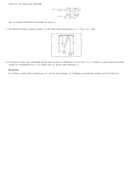

This is a common massless string and pulleys problem. I'd just like to understand why, according to the solution, [itex]l_2 + 2l_1 =[/itex] constant. It doesn't seem to me that two times the [itex]l_1[/itex] length is equivalent to [itex]l_2[/itex]. Can somebody explain?

Bunny-chan said:
doesn't seem to me that two times the ##l_1## length is equivalent to ##l_2##
Indeed not, but that would lead to ##2l_1-l_2## is constant, which is not what is claimed.
Besides, you need to think about changes in the lengths, not the absolute lengths. If l1 increases by x, what happens to l2?
Hm. Will it decrease? Because if [itex]m_1[/itex] goes down, it means [itex]m_2[/itex] has to go up, right?
Let x be the distance in elevation between the center of pulley 1 and the center of pulley 2, y be the distance between the elevation of the center of pulley 2 and the ceiling, z be the distance in elevation between mass 2 and the center of pulley 2, and w be the distance in elevation between mass 1 and the center of pulley 1. So the total length of string is L=2x+y+z. The distance l2 is given by ##l_2=z+y## and the distance l1 is ##l_1=x+y+w##. So, $$2l_1+l_2=(2x+z)+3y+2w=L+3y+2w$$ But, since L, y, and w are constant, ##2l_1+l_2## must be constant.
I was able to understand everything before this point. Why do you take [itex]2l_1[/itex]?
I do ##2l_1## because I need 2x.
Incidentally, I would never have done this problem in terms of l1 and l2. I would have immediately written down the total length as ##L=2x+y+z##, and then differentiated to get $$\frac{dL}{dt}=0=2\frac{dx}{dt}+\frac{dz}{dt}$$ If m1 moves down at the rate of dx/dt, m2 moves up at the rate of -dz/dt.

OK. I get it now, but I don't quite understand the differentiation.
What part don't you understand?
Where did the [itex]y[/itex] term go to?
What is the derivative of y with respect to time?
[itex]\frac{dy}{dt}[/itex]? But since it is constant, it equals 0? Is that so?
Sure
Chestermiller said:
Sure
But isn't [itex]x[/itex] also constant? I mean, the distance in elevation between the center of pulley 1 and the center of pulley 2 will always be the same, won't it?
No, why?
No
Chestermiller said:
No
Nevermind. I can see that now. Thank you!
