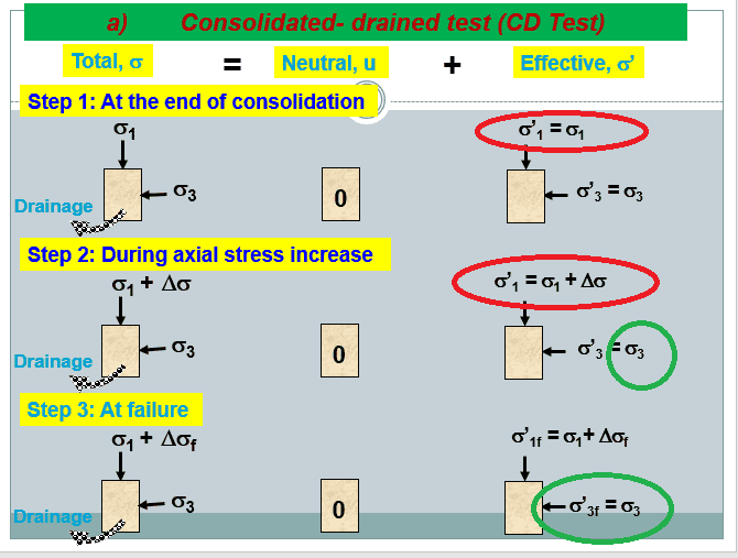

In the first photo , I don't understand why the σ1' = σ1 ?
Since the water is drained from the soil , so i think the first red circled is incorrect ..The shear stress at step 1 should be σ1 only .
For the green circle part , why σ3 = σ3 ' ? Shouldnt it = σ'3 = σ3 + Δσ ( pressure due to drainage) ?

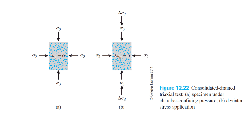

The sample starts out with the compressive stress components equal in all directions, and zero pore pressure. Then, the axial stress is increased, while the transverse stress is held constant (and water is allowed to seep out, so that the pore pressure remains zero). The only question is, why doesn't the transverse stress increase as a result of the Poisson effect. Maybe, by the nature of the test, the transverse stress is held constant.

Do you mean in the case in the 638.PNG , the transverse stress is held constant ?
While in the 639-641 , the tranverse stress is allowed to increase ?
639 doesn't say anything about the transverse stress. But in 640 and 641, yes.

do you mean in 639- to 641 , all the shear stress( in all direction) is allowed to increase ? But in 638 , the tranverse stress is kept constant ?
Sure.
Likes fonseh
We are dealing with the principal stresses here, so there are no shear stresses in these directions.

One more question , why σ1' = σ1 ? and σ1 ' = σ1 + Δσ ?
Because the pore pressure is zero.
