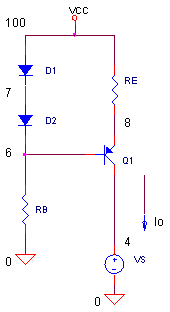

A decent if not precision current source can be made easily from a transistor , zener diode and a couple of resistors.
9 volt transistor radio battery might work fine.
Simplest current source is a transistor, zener diode and resistor.
http://www.ecircuitcenter.com/Circuits_Audio_Amp/BJT Current_Source/BJT_Current_Source.htm
This one uses two garden variety diodes instead of a zener. Maybe 1N4148 - abundant and cheap.
Replacing one of them with a 1N5231 5.1 volt zener should improve temperature performance at expense of output voltage.
For the zener version RE would be R = V/I = 5.1/desired currentand you could use a pot or a switch to select current.
RB just needs to conduct about two milliamps to get past the knee of the zener.
Its value would be R = V/I = (Vsupply - 5.1 )/ .002 ohms .
max output voltage would be about Vsupply - Vzener - 1 volt, only about 3 volts for a 9 volt battery supply.
For the two garden variety diode version RE would be 0.6/desired current
and RB ~( Vsupply - 1.2)/.002 ohms
and max output voltage about Vsupply - 1.2 - Vcb volts, about 7 volts.
A 12 or 15 volt wall wart would work well with the zener source.

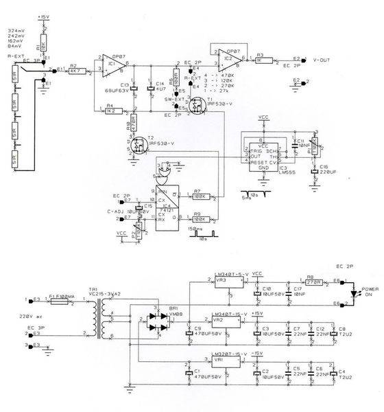

I obtained a schematic of the entire apparatus from the journal article's (retired) author, if anyone is interested.
  • #32
He certainly used good quality parts. Are you familiar with those IC's ?
OP07 is a precision opamp.
Left hand one causes voltage selected by selector switch E1 to appear across R10. That's what sets the charging current through your capacitor C13-C14. Observe when T2 is off no current can flow through R10 so capacitor charging current is zero.
Turning on T1 discharges capacitor through whatever resistance is across E4 terminals.
Right hand OP07 is just a buffer to repeat capacitor voltage over at Vout for your meter there. That way a few milliamps of meter current won't discharge the capacitor. .
74121 is a pulse generator, colloquially called a "retriggerable one shot" or "monostable", that makes a pulse of precise duration every time the 555 gives it a "go" pulse. P2-C15 set that pulse width. Its two outputs are complementary, that is when one is high the other is low.
