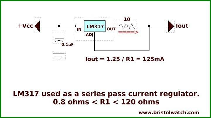

I have also tried another method with a lesser know chip called the lm334 here is a pic of the basic design however I left off the amplifying transistor as well as R2 and R1 with R3 being the same digital potentiometer
http://www.bristolwatch.com/ccs/lm334.jpg
I had some success with this method as I got an output that could range from a current of .7mA to a current less than .01mA. One problem that I had was that I could not find an easy way to amplify the .7mA to 2mA because I am relativley new in electronics and do not have much experience with op-amp circuit design. The source also works by sinking current so that is also throwing me off. The only amplification method that I can figure is to use a PNP transistor as in the diagram but they all have gains that are much too high for my purpose.
It would be awesome if you guys have any suggestions for what I have already tried or any brand new ideas. I think my next attempt is to use a simple op-amp circuit with the digital potentiometer.

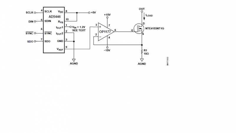

Use a DAC. Use it to drive a voltage to current converter, or a current mirror.
There are current and voltage output DACs with variable reference inputs.

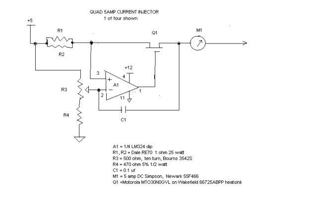

This thread has drawing of a current source i built decades ago:
https://www.physicsforums.com/showthread.php?t=580295
I needed 5 amperes hence the low ohm resistors and power mosfet.
Just wanted to show you the current sense method...
You could put your lamp where i have the the mosfet, forget the meter, and swap opamp's + & - inputs since we no longer invert with the mosfet...
Your digital pot would replace my R3R4.
Make current sense resistor (R1R2 ) = 2.5 K so 0 to 5 at wiper would give 2ma to zero current.
Observe the LM324 needs "headroom" so its supply must be a volt or two greater than lamp supply. I had +12 handy, +7 should work..
good luck !

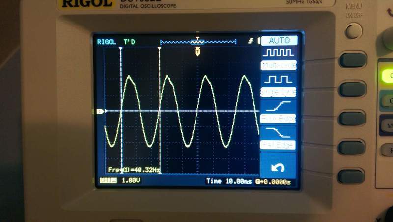

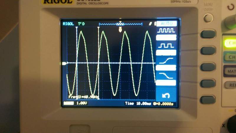

Ok guys another question regarding this circuit. I am trying to use an oscillator circuit that I made in order to control the current source. The oscillator works fine but produces a signal with a DC offset, and the final output needs to be completely AC. In order to remove the offset I placed a .01μF ceramic disc capacitor in series with the output of the oscillator to the current source. I have attached a picture of the schematic for the oscillator circuit and current source.
Now normally the circuit does not work correctly because the opamp in the current source seems to stick to the upper supply rail. I was testing the circuit with my scope and found that when I probe the point between the capacitor and the opamp input and found that when it is probed then the output of the current source works as expected (verified with the other channel on the scope and a multimeter measuring the AC current output). I have made a video showing everything described here if you actually want to see what is going on on the scope. The video can be found here:
https://www.youtube.com/watch?v=t_LNwKp-bCU&feature=youtu.be
At first I thought something was very wrong with the design but the discovery with the scope leads me to believe that it may be an relatively simple fix and due to my little knowlage of AC circuits and opamps. Any help would be much appreciated. Thanks!

All opamps have a trait called "Input Bias Current" , a rather nondescriptive name. I've heard it called "Pump Out Current" which is a little more descriptive. What that is is a trickle of DC current that must be allowed to flow either into or out of the opamp's input pin.
Observe it's maybe 45nanoamps typical for Lm324, 200 max. Look at parameter "Input Bias Current" on this datasheet
http://www.ti.com/lit/ds/symlink/lm124-n.pdf
That small current produces a small DC voltage drop across the input resistor, notice if your input resistor were 1 megohm that'd be 45 millivolts.
But your input resistor is a capacitor which that small DC current will slowly charge to a substantial DC voltage , just as your 'scope shows..
The scope is probably 1 meg or 10 meg input and it provides the necessary DC path to circuit common for the input bias current. That's why it only works when your'e looking at it with scope.
When you study opamp tutorials you'll be cautioned about providing a DC path for those pesky bias currents. You just got to do it.
Patch a 1 meg from that opamp's + input to common and see if it straightens out.

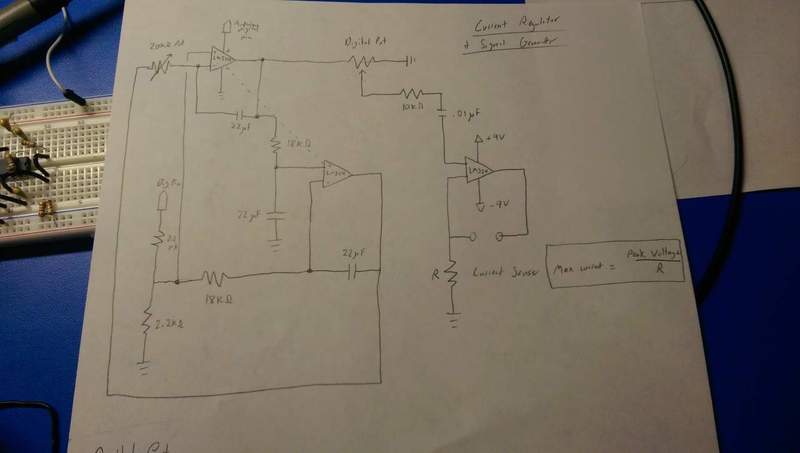

jim hardy has correctly spotted the DC input bias problem, but I still have a few concerns about this circuit.
Placing 1M from opamp +input to common may still make for a big offset voltage.
Rs * I_bias_max = 1M * 200nA = 0.2V
So instead consider moving the 0.01uF capacitor to between the digital pot and the op-amp that drives it.
That will both AC couple and provide a DC path to the opamp input through the digital pot.
At such a low frequency, you will need to increase the value of that coupling capacitor to 22uF.
As with your oscillator capacitors, it will need to be an AC capacitor, not a polarised electrolytic.
The 10k resistor remaining in series between the digital pot and the opamp +input is not needed.
It was there to correct the input voltage difference due to opamp input bias current.
10k * 200nA = 2 mV, which is unimportant, (and the wrong way), in this circuit.
Ideally it should have a value similar to “R” in parallel with the load resistance.
That is lower than the digital pot, so it is better to replace that 10k input resistor with a wire link.

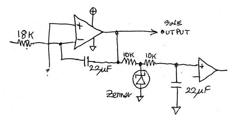

@ HHOboy.
Your oscillator is a low-pass feedback phase-shift oscillator.
I expect it to produce a sine-wave output clipped in amplitude by the (+) and (0) power supply rails.
To get an On–Off signal I would have expected you need a square-wave, not a sine-wave output.
With a phase-shift oscillator, that would require high-pass feedback elements, i.e. swapped R and C.
But there are much simpler controllable square-wave oscillators.
I believed that the original requirement was for a gated, 50% duty On/Off oscillator.
With Off being a Zero current, and On being a programmable current.
Now that you have AC coupling, there will be positive and negative controlled currents.
That will produce positive and negative output voltages across the load.
With the sine wave there will be a short low current period, there will be no 50% duty Off.
Maybe AC coupling with the 0.01uF capacitor was a distraction and should never have been inserted.
The 50% duty cycle problem being all along due to the sine-wave oscillator output.
The digital pot needs to be handed signal that lies between its supply rails so i don't think it can handle negative . The cap needs to stay on its output side.
Agreed with Baluncore the 10K is not needed.
Since you're driving the rightmost LM324 as a follower, Zin is very high so the cap can remain small; Baluncore and i differ there..
At 40 hz a 0.01uf cap is 398kohms , so using a 1 meg resistor to provide return path for bias current won't hurt you frequency wise. You've already seen that with your scope.
frequency rolloff starts when Xc = R,
and
Xc = 1/(2∏fc) .
If you went to a 0.1uf cap and 100K resistor it'd assure offset due to max input bias current of 200na stays less than 20 millivolts (0.2ua X 1/10 meg = 20mv)

Does the oscillator generate a sine or a square wave ?
I still think AC coupling is the problem, not the solution.
It was a very decent looking sine wave;
quadrature oscillator , fig 8 here
http://www.ti.com/sc/docs/apps/msp/journal/aug2000/aug_07.pdf
AC coupling with no provision for bleeding away bias current was sure enough the problem.
Shorting the cap should give him sinewave centered around ( 2.5 volts X pot setting)/(Rsense) .
Maybe he'll try it for us ?

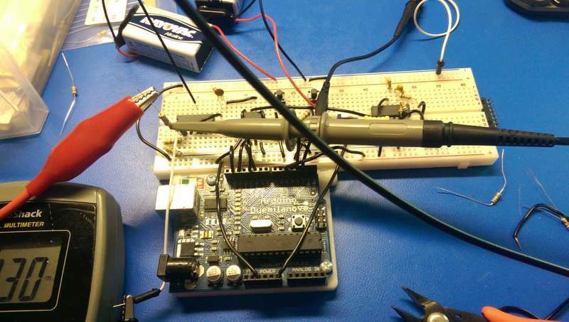

Sorry guys I had to work last night and this morning but now I have some free time. I put a 1MΩ resistor between the input of the opamp and ground as suggested and that has done the trick! Also I removed the 10kΩ resistor that you guys said was unnecessary and that seems fine as well.
I wanted to thank Jim for the excellent explanation of the pump out current, it makes sense and I can add it to the list of things I have learned from this project.
Regarding Baluncore thanks for the point that the 10KΩ resistor is unnecessary. Also the current output does need to be true AC not just alternating between 0V and 5V, and it does need to be a sine wave as well.
I have attached several pictures so that you guys can see the final product and so Baluncore can see the wave because of the youtube problems. The first picture is just the updated breadboard you may be able to see the 1MΩ resistor behind the cap on the left of the board, also I removed the 10kΩ resistor and replaced it with a wire connection. The second picture is the waveform that I get on the simulated load resistor(in this pic it is 2KΩ). The third picture is the same as the second but I raised the value of the load resistor to 4.7KΩ and you can see the corresponding increase in amplitude to maintain a constant current of approximately .30ma AC. Also it should be noted that I am not probing that capacitor in the second and third pictures, so the problem is fixed .
Now I plan on trying to reduce the distortion that can be seen on the top of the sine wave and bring the frequency closer to 40 Hz. I think that getting some more precise components for the oscillator and putting the circuit on a proper proto board will help some.
The flat top is due to the amplitude being set by the opamp output hitting the supply rail limits on the amplifier stage where you pick off the sine wave.
To greatly reduce the flat top you must limit the amplitude in the LPF after the take off point. That will allow all three low-pass filter stages in the feedback oscillator to remove the odd harmonic distortion before the signal is used.
Attached is a crude first approach to softer amplitude limiting.

A simple LM317 voltage regulator with a current-setting resistor between OUT and ADJ pins seems easy...
http://diyaudioprojects.com/Technical/Current-Regulator/ see fig 2
probably should heat sink the LM317

and i'd try an inexpensive everyday opamp liike LM324, which has added advantage it's suitable for single supply.

Oops, I am just reading Old Jim's reply. Yes, I actually ordered the LM324 opamp yesterday. My question about this op amp is can it do up to 165mA load on its output?
If so, are you suggesting I use it to replace the AD8510 or OP1177 in the figures in MBG's post?
Thanks, Science Advisor! :)
  • #33
no, check its datasheet. There exist opamps that can deliver such current but they're expensive. I used LM12's, good for 8 amps, when they were only about $20 but last time i looked they'd gone up to over $80.
It'd replace the OP1177 .
Read up on that National Instruments computer you're using. If it has analog out,
then see fig 2 here, from that Analog device MBG linked: http://www.analog.com/static/imported-files/circuit_notes/CN0151.pdf
Do you see that the opamp is connected as a follower that will make 100milliamps per volt applied to pin 4 three? That stout FET handles the current for it.
