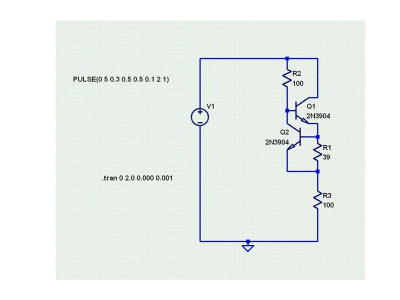

Take your op-amp and set it to one side. Take two NPN's and make a current source like the one in the attachment. This one regulates the current in R3 (100 ohms) to 27 mA (2.7 volts). This means that the voltage drop in the regulator resistor R1 (39 ohms) is ~1.05 volts.
Bob S
