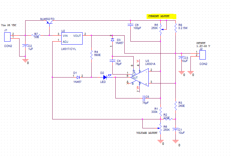

Please see the upload file.
here am using the circuit to build in range of 1mA to 500mA.
The circuit i found somewhere in the forums as a car battery charging.
The problem with the circuit is instead of CURRENT ADJUST USING POT am using DIGITAL POTENTIOMETER.
How can i replace the current adjust pot with 9 bit digital pot?

There is a problem with using the battery charger circuit. The battery charger circuit is a voltage regulator with a crude current limiter. Current flows to the output through two paths. Firstly; through the adjustable voltage regulator LM317, and secondly; through the series pass transistor MJ4502. The 33 ohm resistor limits the current through the LM317 to about 20 mA, with about 10 mA base current from the MJ4502. That 30 mA is temperature dependent. The LM317 current is not monitored by the current sensing resistor, R8.
It will therefore be necessary to design a new circuit that measures the total output current. That circuit will source a specified current, by adjusting the output voltage across the load. The question comes as to what maximum voltage output you will require across the load?

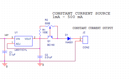

How can i replace 500 ohms variable pot with 10K ohms Digital pot in the circuit??
Problem is when i replace the digital pot 10k, i need to adjust current in the range of 1mA to 500mA acccording to change in the 10K digital pot.
How the circuit can be modified with 10k DIGITAL POT and the output must in precise current with 1mA difference.

Sorry about the delay. I have a few potential circuits available, but there are still a number of indeterminate questions with this design.
Firstly; The voltages applied to the analogue terminals of the digital pot must remain within range of the pot power supply rails, those rails will most often be 0V and +5V. For this reason, the battery charger circuit will be difficult to modify because the pot is floating well outside digital supply voltages. The current “source” requirement is the problem. Placing the load above a controlled current "sink" resolves that problem.
Secondly; a digital pot will need digital control, that might be a serial data stream or a parallel interface. Providing that digital control will be critical to selecting and implementing the digital pot. I have no idea how you intend to control the digital pot or what constraints you will have doing that. Using a serial interface will reduce the hardware, but what will you be driving the digital inputs with?

Ramana needs an infinite impedance, digitally programmable current, of between 1 and 500 mA. It needs about 12V of compliance.
It is an easy enough design problem when the outside interfaces are known. A digital pot is used to generate an adjustable voltage, like a DAC. The programmable voltage is compared with the voltage across a current sense resistor while a series MOSFET gate voltage is adjusted to regulate the current through the load and sense resistor. The characteristics of possible loads set only the maximum output voltage needed, that in turn dictates the maximum power rating required of the MOSFET should the load become a short circuit.

Capture.png attached to post #3 shows a pot being used to set a current limit. R5, 250k, highlighted in yellow.
The OP wants to replace the manual pot, R5, with a digital pot.
The battery charger circuit is an antique that does not meet the OP's current source accuracy requirements.

I looked at that circuit and it seems to be an adjustable Voltage regulator circuit with an adjustable current limit(?) So it doesn't seem the place to start from.
You are correct, but that was what the OP came up with. If the voltage is increased until it limits the current, then it presents one uncalibrated solution.
