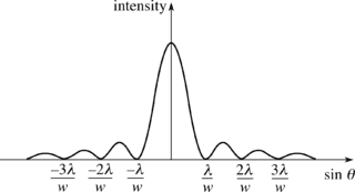

When we look at the intensity of light on the screen in a double-slit interference experiment (assuming negligible diffraction), we find something like this :
When we look at the intensity of light on screen in a single-slit diffraction experiment, we find something like :
In the first case, the intensity maxima is constant. In the second case, it decreases. Why this difference ?
My best guess would be that when dealing with the double-slit interference in textbooks, we always assume a short distance to the center of the screen, thus having maxima pretty much the same. While with diffraction even at those short distances maxima falls rapidly. Would that be correct ?
I also wonder if a forever constant maxima wouldn't violate conservation of energy ? Light can only be emitted for a finite period of time, so, the amount of energy reaching the screen must be finite. Therefore, light intensity on the screen must vanishes at some point right ? Even with the double-slit interference without diffraction. Is this reasoning correct ?

A double-slit is not a single slit.
In a real double-slit experiment, you have both patterns together (multiplied). As the typical slit distance is much larger than the slit width, the double-slit pattern is narrower, so the full first picture fits into the main maximum of the second picture. With a good double-slit setup, you can see both patterns at the same time.
In the ideal two-slit setup, with a negligible slit width, there are two pointlike sources of waves. At each point on the screen we add two waves with different phases. As you move outwards from the center of the screen, these two waves are first in phase (reinforcing each other), then out of phase (cancelling), then in phase again, then out of phase again, etc., in a regular fashion.
In a single-slit setup, with a non-negligible slit width, each point across the width of the slit acts as a source. At each point on the screen we add (integrate) an infinite number of waves. They all have the same phase only at the center of the screen. At other locations, the waves have a range of phases that can at best partially reinforce when you add them all together.

While I understand that the setup of both experiments, and thus the interferences, are different, I still find surprising that light intensity seems infinite in the idealized double-slit interference experiment. Infinite light intensity means infinite energy, which is not possible.
Any way I look at it, I must conclude that, in an idealized double-slit interference (two pointlike sources of waves only), at some point along the screen sides, light intensity MUST vanishes. Either maxima simply stops abruptly, or they decrease slowly. The equation describing intensity must be valid only under certain conditions where maxima are constant.
How could it be different ? How could intensity maxima repeat themselves forever ? Where would the energy come from ?
There is a finite number of maxima in the double-slit experiment, given by slit separation and wavelength.
They are evenly spaced in sin(theta) where theta is the angle relative to the central maximum, and the sine is limited by +-1. They are not evenly spaced with a planar screen. This is a reasonable approximation close to the central maximum, but doesn't work further outside.
This is of course the approximation that we almost always assume in introductory treatments.
Also, introductory treatments assume the screen is very far from the slits compared to the width and spacing of the slits, so that we can consider the light rays from the slit(s) to a given point on the screen as if they were parallel. This is called Fraunhofer diffraction. Relaxing this condition leads to Fresnel diffraction, which can produce interesting intensity patterns, including (for a circular aperture) the famous Poisson spot.
I suspected that the parallel rays approximation could be a reason why the derived equations in those introductory treatments would be only valid up to a certain point. Thanks for the clarification.
