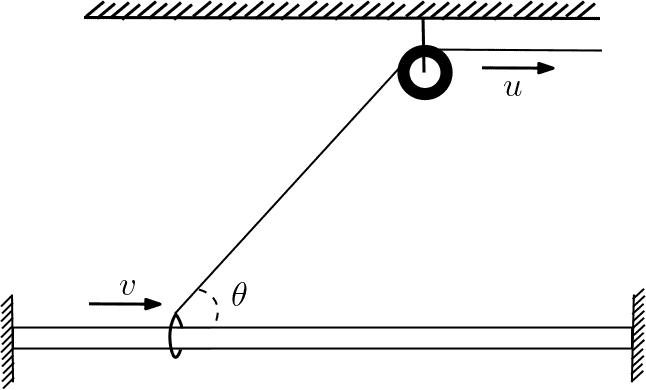

If the velocity of the ring is v as shown in the figure then find the velocity u with which the rope is being pulled?

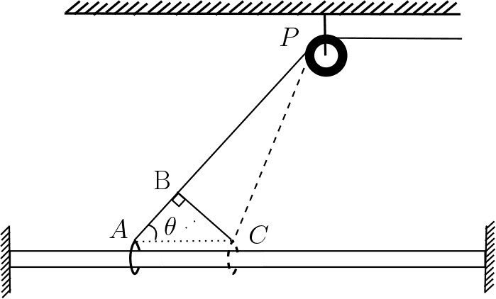

The correct answer is [itex]u=vcos\theta[/itex]. I have understood so far to be able to conclude that [itex]\text{displacement of string} = PA - PC \approx AB[/itex]
Also, [itex]\overline{AB}=\overline{AC}cos\theta[/itex]
or, more generally, [itex]\vec{S}_{along\ the\ string}=(\vec{S}_{along\ the\ horizontal})cos\theta[/itex]
Now, I had hoped that simply differentiating both sides of the last equation with respect to time would give me the expected answer. But, since [itex]cos\theta[/itex] is not constant, doing so does not yield [itex]u=vcos\theta[/itex]. How do I proceed from here?

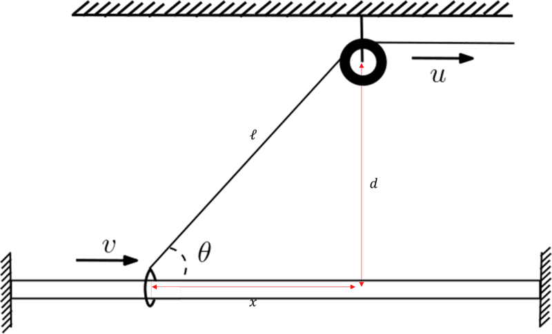

Drop a line perpendicular to the rod at the pulley, it has a fixed length ##d##. From the ring to the intersection (along the rod ) is ##x##. From the ring to the pulley is ##\ell##.
Examine that triangle with implicit differentiation w.r.t. time.

Why differentiate? That would be appropriate if your equation related position of the ring to position of whatever is pulling the string, but instead you have found the incremental change to each of those. That is, you have already differentiated.
An easier approach is to say that the rate at which the ring is approaching the pulley is simply the component of v in that direction.

You did not write any ##\Delta##s in post #1. You could write AB and AC in terms of u, v and ##\Delta t##, then divide by that last.
And you did not define ##\vec S##. Is that supposed to be speed or displacement?

You mean like [itex]\vec{S}_{along\ the\ string}=(\vec{S}_{along\ the\ horizontal})cos\theta \implies u\Delta t = (v\Delta t) cos\theta \implies u=vcos\theta[/itex]?

In post #7, you stated that the S variables were "displacements”, so vectors. I guess you meant distances, since they are in different directions. If so, they would be OA and AP, i.e. ##constant-x, l##. But that is not how you used them.
The general equation relating the ring's position and its distance from the pulley is ##x^2+d^2=l^2##. Differentiating, ##x\dot x=l\dot l##, so ##xv=lu##.
Since ##x=l\cos(\theta)##, ##v\cos(\theta)=u##.
Instead, the way you used them, they were small changes in those distances. In considering such, you had already, in effect, differentiated.

I understand the part where you say that the way I did it, they are not actually position vectors, but changes in distances. But, what do you mean by "already differentiated"? How is this "already differentiated" when clearly we use differentiation to compute the "rates" of change?
You pretended it was a differential change in position when you said ##\bar{PA}-\bar{PC} \approx \bar{AB}##. So ##\theta + \Delta \theta \approx \theta ##. So all that left to do is divide by ##\Delta t ## and take the limit.
