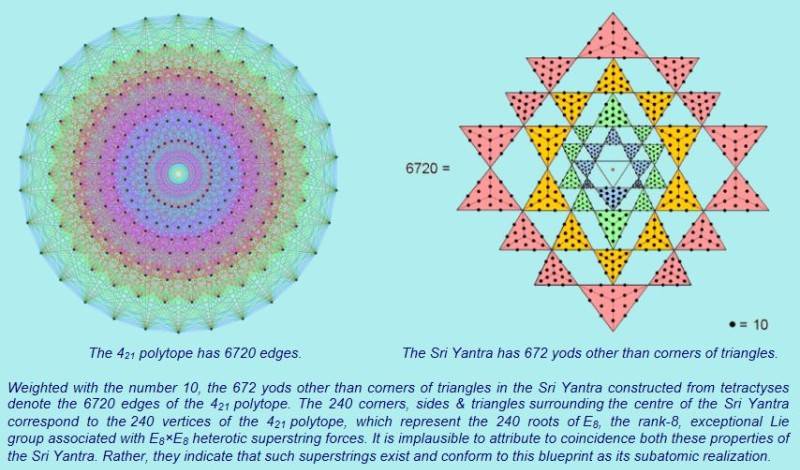

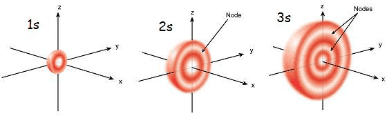

Look at this... Similar to your Lie group, the Polytope in the first picture you linked? This S orbital?

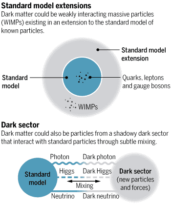

When I model Dark matter versus normal matter in "Toy Models and Theoretical models" that I construct, I do it as super-symmetry across flavour a property of the Higgs Mechanism on the Weak Nuclear Force denoted by the variable "Y", but you could do it many different ways for example which explains the same thing this does in a different model's math, This is just one of those things they did because it seemed to make sense in the context of Heterotic String's Math to explain the observed states of matter, in my opinion.
So, the actual constraints are what types of matter and particles do we actually observe in the universe and what causes them. The easiest way to explain it in the context of "B".
Think of Matter and Antimatter with the opposite Electric charge and opposite "Color Charge" it is the same idea applied in a different area upon a different property these "Shadow Matter Particles" being across Spin Number.

Sure, Here is a paper about WIMPs, which is the form I was speaking about but on ARXIV. but there are many possible candidates for Dark Matter.
https://arxiv.org/abs/1707.06277

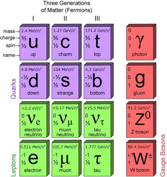

Yes, when Electric Charge of matter and antimatter meet that are equal and opposite changing the form of the particles to photons or other particles causing a symmetry break upon Electric charge like in the scenario of Positrons and Electrons meeting making Electric Charge neutral photons of equal Energy-mass from the previously two (+1,-1) Electric charged particles's Energy-mass.
Photons being a neutral state of Energy-mass for Electric charge or in a 0 State of Electric Charge.

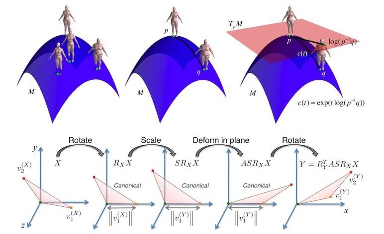

Well, in String Theory, the it is a smooth Reimann manifold type which means it is a differential manifold meaning it is a geometric differential equation basically, so how is it possible for 11-D strings to fit on 10-D space-time, well that is due to the fact that it can bend in 11 different ways or "Degrees of Freedom", being 11 properties effect its shape. If you have taken differential geometry or Multi-variable calculus you will fully understand what I am saying but for those that don'tLet's first start with the Idea of Gaussian curvature "K" of a Volume's Surface over (X,Y,Z)
Morphisms on a Smooth Riemann Manifold of p to q over M being a surface over multiple changing variables.
Morphism over L = Z with a change in several Variables in Smooth Riemann Manifold
Higher Dimensional Morphism over many variables 11, in this case, Calabi Yau Manifold for String Theory at every point of space like "SR Light cones" in GR.
That is how it is possible those "Degrees of freedom" are just variables that effects its shape like K in Gaussian Curvature.
