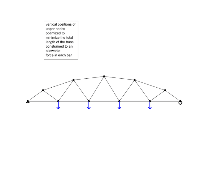

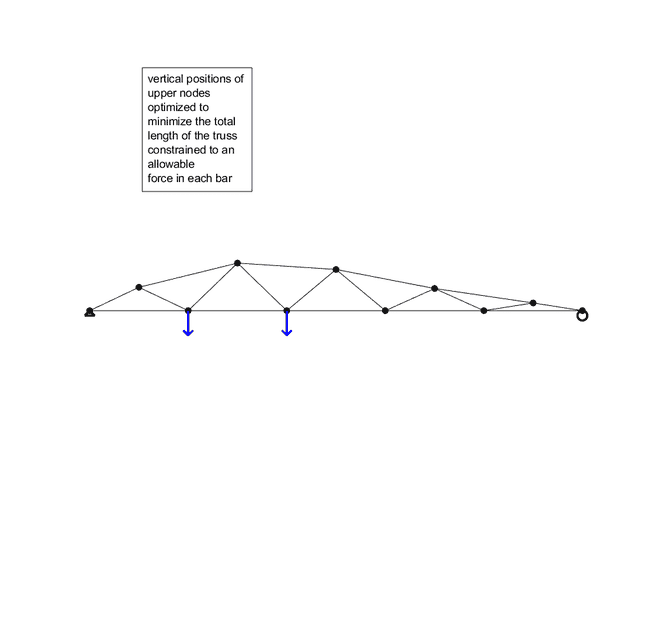

I started working on it in MATLAB which has a function (fmincon) for nonlinear constrained optimization. I had it optimize a truss geometry for different loading conditions (minimize the total truss length), but the code used could then also be used to, for example, optimize the bar cross-sections (minimum area that can support the loads) by simply plugging in a different set of constraints as text. Since optimizing truss geometry is probably the most ambitious optimization I would imagine using it for, I think it could be used for a variety of other applications for more basic engineering design. I still haven't implemented if statements

I'm thinking of limiting it to structural analysis which is basic enough for simulations and advanced software to be unnecessary. I would like to use it for my own purposes where I'm working, but I would hope it could be used by other people doing similar work.
